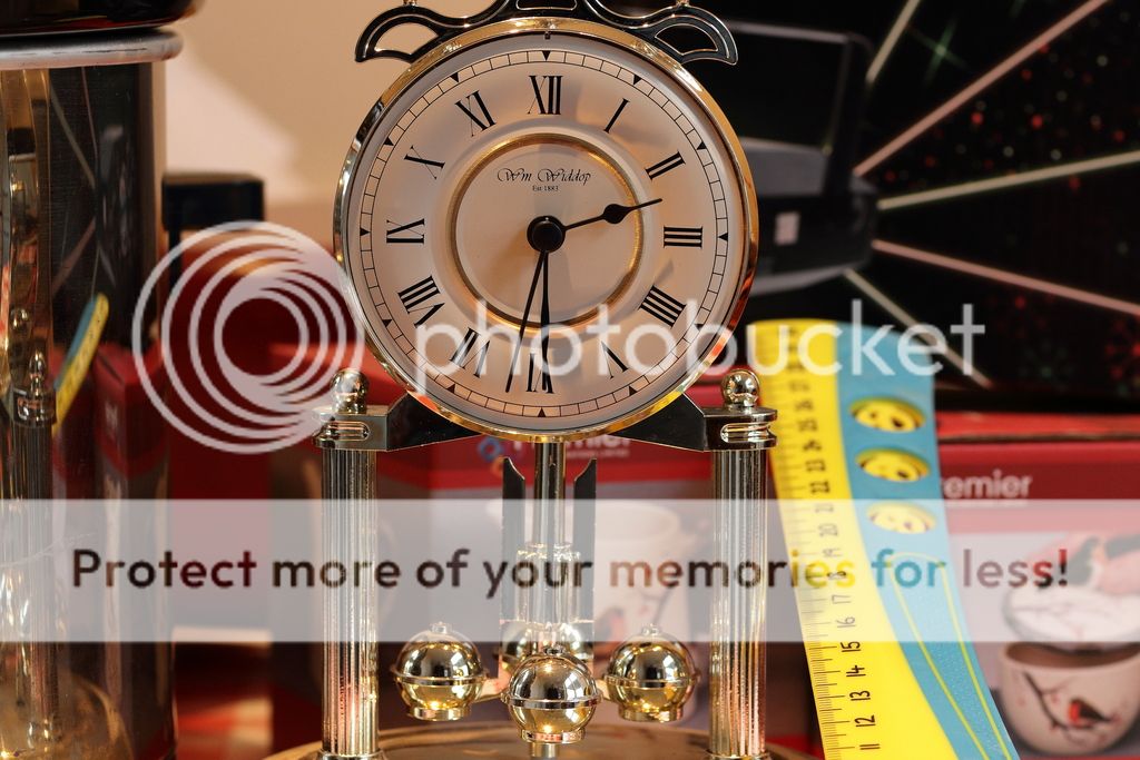

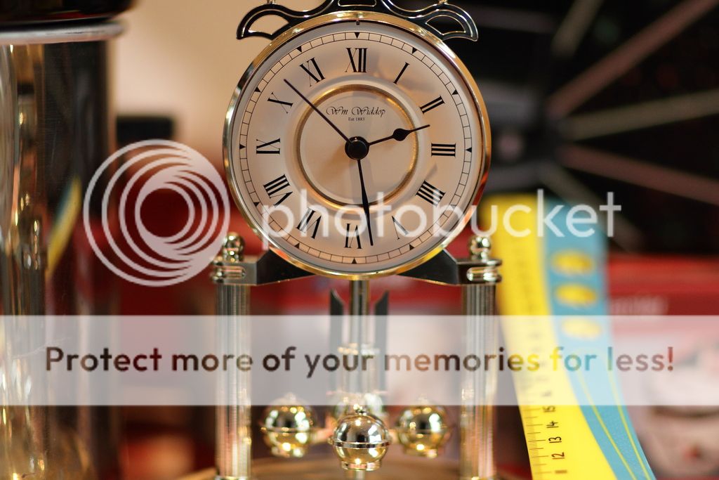

Oct 18, 2015 01:57 |  #7
Here are a couple of examples.
In truth, since converting them to jpeg and uploading, what I'm seeing is not as pronounced as in the raw files.
I have not applied noise reduction to the pictures.
I'd also like to point out that I don't think the iso noise is bad but it does look different across the aperture range.
http://i628.photobucke​t.com …nr%20f1.2_zpsc8​tyhezi.jpg (external link)
http://i628.photobucke​t.com …nr%20f5.6_zpsyu​ovsc4u.jpg (external link)

Oct 18, 2015 03:23 |  #8
I think it's all about the different amount of blurred, detailless areas, where noise is more evident.

Oct 18, 2015 05:12 |  #9
I downloaded the f/11 version. My first impression was that this is a very clean file. I ran it through LR and Noiseware, independently. There is a little bit of noise, but it is easy to work with. I'd be happy with files like those at ISO 800 from a crop camera. I have no problem using my 70D at ISO 6400. I'll use ISO 12,800 but I realize they are not going to be stellar IQ. Your 7DII seems to be about equivalent. Maybe you just need to develop the ability to pixel peep while processing, and only judge the final results. The file I looked at is more than acceptable.
With your permission, I'll post before and after screen shots of my LR edit, full frame and 100% crop.

Oct 18, 2015 08:54 |  #11
Noise is controlled by exposure and iso levels. CA is noticeably different by aperture though. Noise can be accentuated, ie more noticeable, by white balance and looking closely at OOF areas. Your aperture is not directly causing any differences in noise, however slight exposure differences would explain that.

Oct 18, 2015 09:00 |  #12
I looked at all of them online. I only downloaded the f/11, since it would have the most DOF. I am not sure if that means the noise would be more visible or less. I'd shoot that camera at 6400 without hesitation.
B/A, then 100% B/A
IMAGE: https://photography-on-the.net/forum/images/hostedphotos_lq/2015/10/3/LQ_754326.jpg
Image hosted by forum (754326) © Bassat [SHARE LINK]
IMAGE: https://photography-on-the.net/forum/images/hostedphotos_lq/2015/10/3/LQ_754327.jpg
Image hosted by forum (754327) © Bassat [SHARE LINK]
