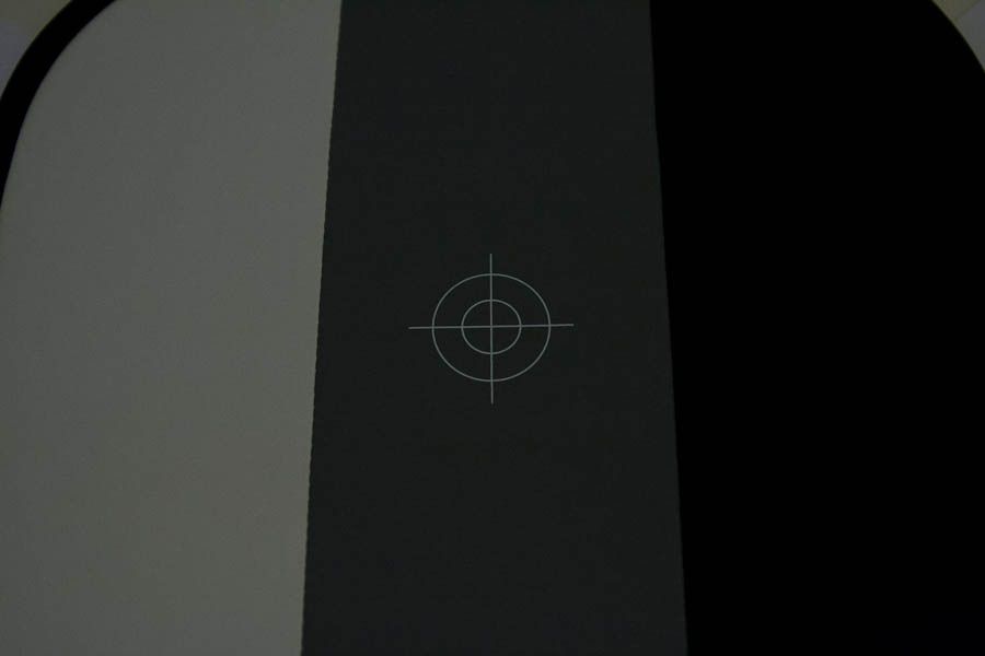

Furthermore, at -2EV the background is NOT a 'black background' at all...it would take about -3.66EV underexposure to be truly 'black'. Here I shot a 3-tone target at -2EV, and you can easily differentiate the midtone vs. the black part of the target
IMAGE: http://i69.photobucket.com/albums/i63/wiltonw/Principles/-2EV_zps0r5jcoip.jpg

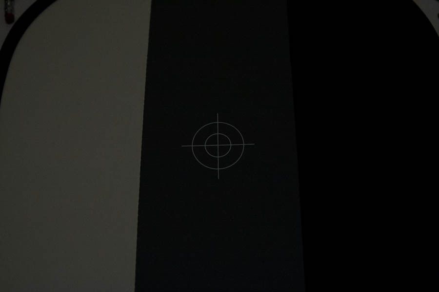

...and even at -3EV it is still possible to somewhat differentiate the midtone vs. the 'black' (if your monitor is adjusted properly)...the sampler dropper quantifies 9-9-9 in the midtone area vs. 1-1-1 in the 'black' area for R-G-B values.
IMAGE: http://i69.photobucket.com/albums/i63/wiltonw/Principles/-3EV_zpsqwryowyr.jpg
