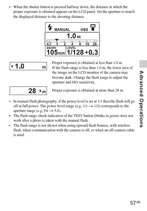

I have the Sony HVL-F60M flash... I'm reading flash photography books and the manual and still can't figure out how to use it.
I can't find any videos or articles on how to use it either.
I want to shoot in manual but I can't figure it out. In the book I'm reading the author is using a Nikon SB-900.
With that flash he changes the f stop and turns a dial or presses buttons until it tells him how far he needs to be from the subject. He also changes the ISO I believe on the flash to help it calculate the distance.
I can't do either on my flash. So I don't know what to do??? I'm sure there's an answer but I can't figure it out and I'm getting impatient!
Please help if you know the answers or have this flash. Even sending me to a website or somebody to ask would be much appreciated!
Thank you!
Seth

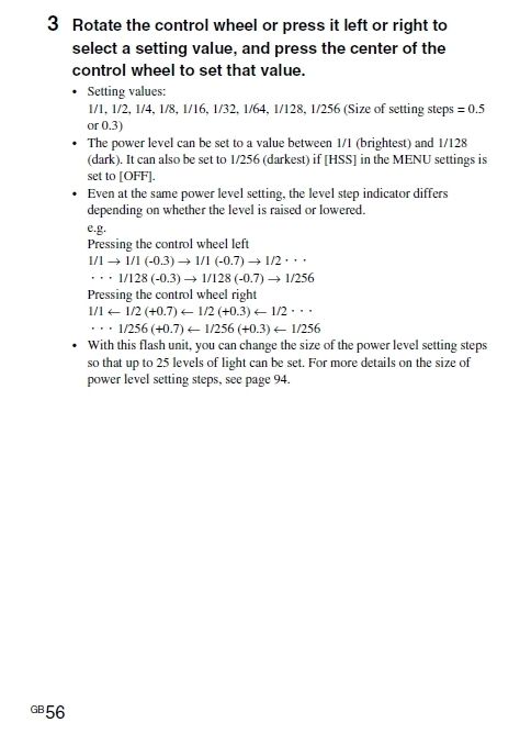

You should disregard what someone else does with a Nikon flash. Stick with the Sony manual and you should be able to figure it out.
The Sony flash manual seems pretty straight forward.
IMAGE: http://i2.photobucket.com/albums/y17/msowsun/photo%20stuff/photo16/_001sony1.jpg
IMAGE: http://i2.photobucket.com/albums/y17/msowsun/photo%20stuff/photo16/_001sony2.jpg
IMAGE: http://i2.photobucket.com/albums/y17/msowsun/photo%20stuff/photo16/_001sony3.jpg

My ancient Sunpak will show recommended distance when ISO, f number, zoom, and power are set on the flash. This assumes the flash is on the camera (or if off-camera, the same distance as the camera to the subject) and no modifier used.
The Sony manual, page 57, states distance isn't shown if the flash is used off-camera.

oldvultureface wrote in post #17872196 (external link)
weird.
really makes no sense.
all my ancient (and newer) flashes will give distance info off camera.
PSA: The above post may contain sarcasm, reply at your own risk | Not in gear database: Auto Sears 50mm 2.0 / 3x CL-360, Nikon SB-28, SunPak auto 322 D, Minolta 20
oldvultureface
4,279 posts
Gallery: 85 photos
Likes: 385
Location: Northwest Indiana USA
Jan 25, 2016 13:20 as a reply to  @ Left Handed Brisket's post |  #9
A distance readout is only relevant if the flash is the same distance from the subject as the camera, pointed directly at the subject, and not bounced or modified.
