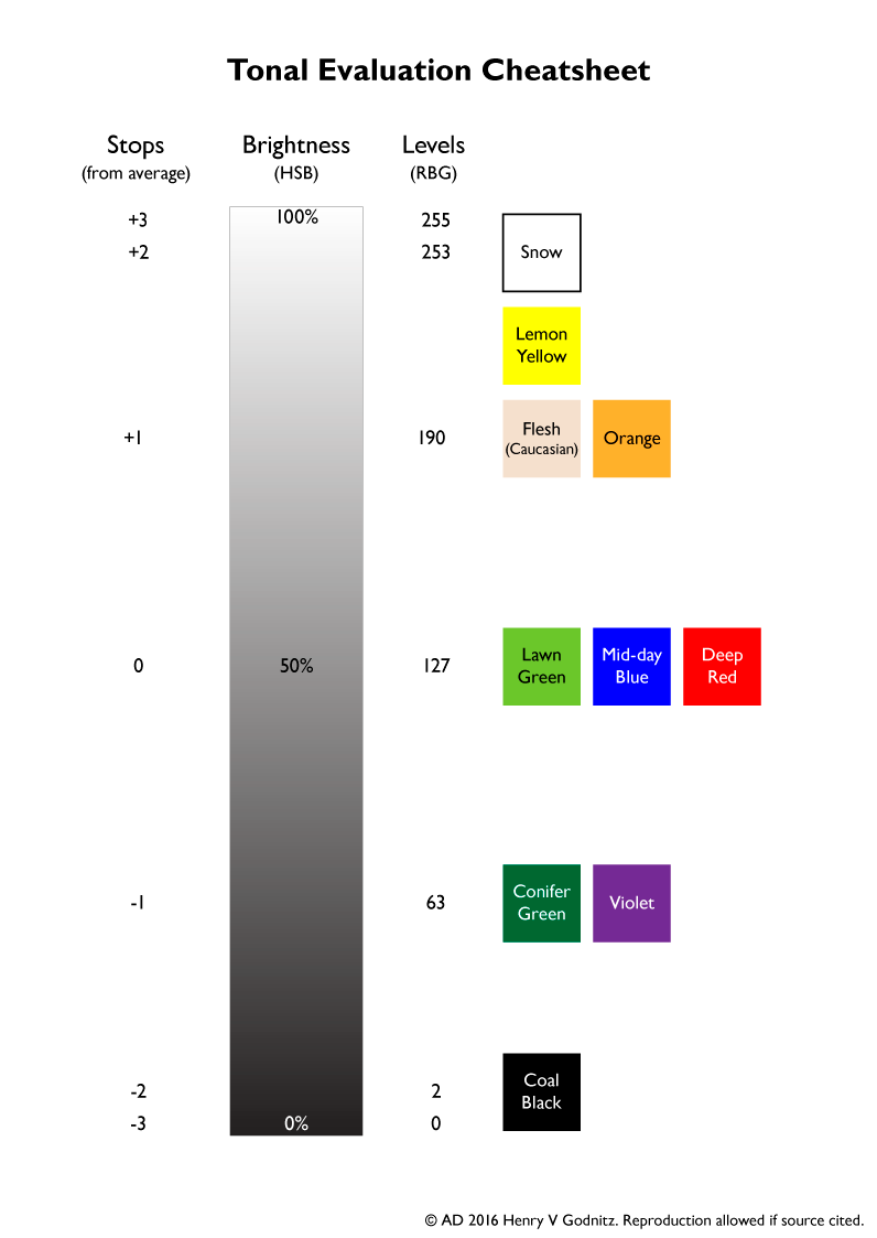

As long as you know what the camera is doing, you should be fine in any mode, methinks.
You can use a cheatsheet to anticipate how the camera will see a particular tone or hue and adjust accordingly, either via EC or shutter speed/aperture/ISO in manual mode.
IMAGE: http://www.diamantstudios.ca/Gemeines/Bilder/Tonal_evaluation_cheatsheet.png
Note there how white normally requires you to compensate by +2 stops from what the camera 'feels happy' with; applying such compensation will render the white, er, white while still maintaining detail. Going higher than that, the white is blown out to pure, irrecoverable white. Likewise for the shadow end.
HTH

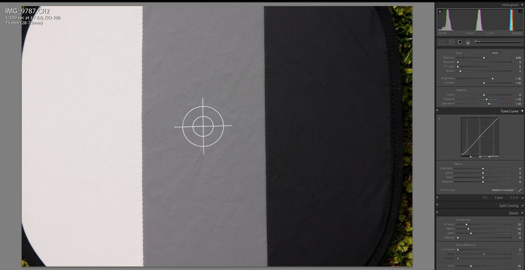

Here is a photo with Spot reading taken on the grey card (exposure made in M, tp permit reframing shot without the meter reading an unwanted part of the frame), resulting in perfect recording of the grey card as a midtone:
IMAGE: http://i69.photobucket.com/albums/i63/wiltonw/Spotoncard.jpg
And here is a shot of Eval reading also taken on the grey card, and the grey card is considerably underexposed because the camera factors in all the adjacent metering zones, although it does give priority to the AF zone measurement. But you cannot predict with much accuracy how much EC you need to dial in. Yes, you can work with Eval a lot and learn to somewhat guess what it needs for EC, but it is always a guess:
IMAGE: http://i69.photobucket.com/albums/i63/wiltonw/Evalcard.jpg
Compared to the vaguary of Eval, both Spot and Partial merely read the brightness falling within the small circle or slightly larger circle meter area, and suggest an exposure to record that area as a midtone on the histogram. Period.
If you can assess the inherent brightness of the target, you can predictably know how much EC has to be used to record that target at its inherent brightess in nature...black is recorded black, white is recorded as white, 85% grey is recorded as very light grey, and 18% grey is recorded as the midtone -- even if my spotmeter was not pointed at the midtone target when taking the spot reading.
