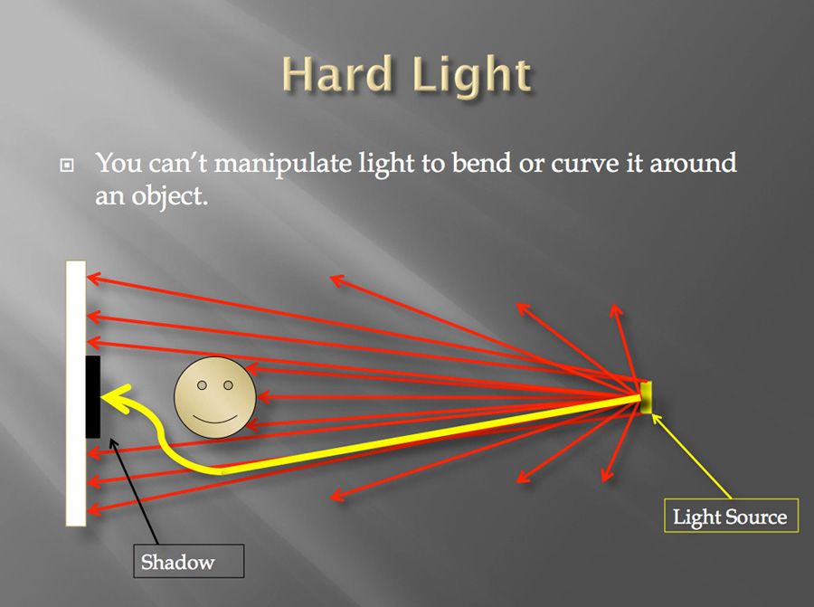

I at one time spent a lot of money on all the gismos out there trying to find the perfect on flash diffuser. After taking a few lighting courses and hanging around here realized it was pretty simple and just basic physics.
IMAGE: http://i33.photobucket.com/albums/d74/Zenon1/Technical%20Lighting/Untitled_zps28f069cd.jpg~original
IMAGE: http://i33.photobucket.com/albums/d74/Zenon1/Technical%20Lighting/Untitled-2_zps7aa9eb32.jpg~original
IMAGE: http://i33.photobucket.com/albums/d74/Zenon1/Technical%20Lighting/Untitled-3_zps2aafaec6.jpg~original

so take that last light source and add a grid, much more contrast because the light is collimated.

So, correct me if I'm wrong, but a grid would therefore concentrate the light but also make it harder.
