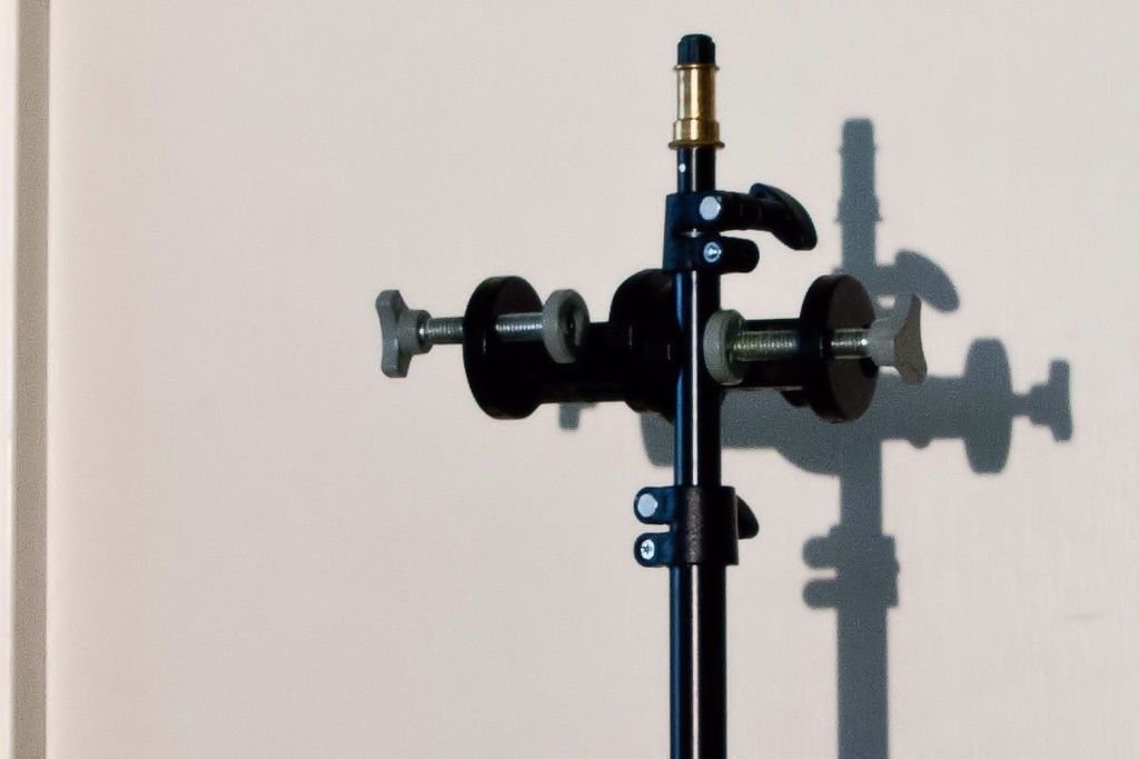

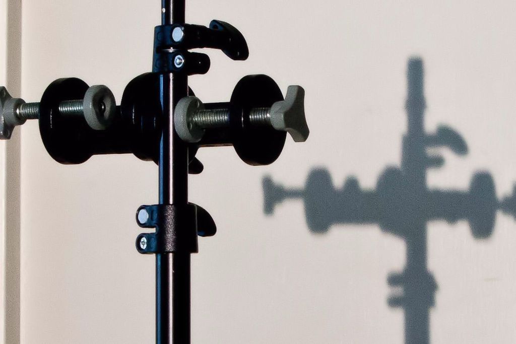

I decided to run a test series to illustrate what happens with a Fresnel source along with a snoot, positioned 14' from the target wall.
My light-blocking object was a light stand with accessory clamp at the top, positioned at 11" from the target wall at the closest and stepped outward to 31" from the target wall as the farthest position, at about 4" incremental distances in the series.

Larger comparisons of the two extreme positions
IMAGE: http://i69.photobucket.com/albums/i63/wiltonw/Principles/snooted%20fresnel-1_zpsiwvtrzyr.jpg
IMAGE: http://i69.photobucket.com/albums/i63/wiltonw/Principles/snooted%20fresnel-2_zpsntbtotua.jpg
Not much of a visible penumbra can be discerned, but we do see some lessening of the umbra's contrast as the distance from object to target wall was increased. BTW the ambient light was -2EV dimmer than the illuminated area.

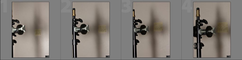

Mar 07, 2016 13:43 |  #43
To show the changes as the distance from light source to subject increases from 2X long dimension thru 5X long dimension, here is a series taken with a small softbox (13cm x 20cm) at 40cm(2x) , 60cm(3x), 80cm(4x) and 100(5x) cm from subject, and the target wall is 75cm behind the subject.
IMAGE: http://i69.photobucket.com/albums/i63/wiltonw/Principles/2s%203x%204x%205x_zpsusoyswlm.jpg
As you can see, 3x is about the limit of 'soft' and the 4x and 5x distances are appearing more 'hard' than 'soft'
