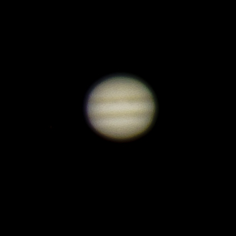

I need to do some manual focus bracketing. I never got it completely in focus. Even when using the focus magnification on my camera it is hard to see if it is perfectly in focus. Any tips for hitting focus? I'm using my telescope & barlow listed in my signature and the Sony A7RII. This was just the first round of testing tonight. I may go back out in a few minutes and try to shoot another. I dunno if this is about the best I should expect from my equipment, but I think that there is definitely some room for improvement in my technique.
IMAGE: http://chuck-d.net/images/potn/Astronomy/Jupiter%202016.03.06%201.jpg

Excellent. Very clear. Color could shift a tad to blue.
As a single shot image, hard to make it any better.
Of course things could be different if you use RegiStax with a short, say 90 second of AVI file processing.

Thanks! I forgot about the technique of extracting a frame from a movie. I'm definitely going to shoot a movie tonight, thanks for the reminder. I don't have my video processing tools installed on this computer so it will take longer to process it, but I'll just grab the source so I have it for when I can do the editing. I'm also going to do some focus bracketing, which should help me hit the focus a little better, I hope.

Nice test shot. Don't forget that with the video file, you will be getting a whole bunch of frames. The software will pick what you tell it to pick. Maybe the others can give you a better answer, but I'd guess 200 frames from a 90 sec clip if your conditions are good.

Yeah, I've never even looked at RegiStax yet. But several people have recommended it. I think my camera can shoot something like 100 fps at 4K, though I may step it down to Super 35 for this video. I haven't had this camera very long yet, so I'm still learning all its functions, configuring my custom buttons and custom menu, getting comfortable with the change of controls from Canon to Sony, etc. All the growing pains of a new camera combined with a system switch. Only time and practice will solve those issues, but in the long run I think I am going to like the Sony controls more than the Canon controls.

read up on Registax. Higher res is not always better. Seems like 640x640 crop works well.

The same seems to be true of video captured with the Sony A7RII, so switching to Super 35 instead of 4K is probably best for both. I have a lot to learn about both RegiStax and my new camera's video capabilities, though I didn't really buy this body for video. I appreciate the guidance, thanks.

Normally "webcam" resolutions work best. You'd think big megapixels cameras would be king here, but that's not why the image looks soft.
It looks soft because Jupiter is tiny. Even at opposition (tomorrow is opposition... the point where Earth "passes" Jupiter as we go around the Sun because Jupiter takes about 12 Earth years so we pass Jupiter every 13 months) when Jupiter is as close and as large as it will be all year Jupiter is only 44 arc-seconds from edge to edge. That's tiny.
The moon (in contrast) is about 30 arc-minutes. That makes the disk of the moon nearly 41x wider than the disk of Jupiter.
With atmospheric "seeing" conditions, you'll be hard pressed to get any single tack-sharp image. But when you shoot video, some will be better than others and some will be partially better than others.
Programs like Registax sift through your images and find the best frames automatically and then combine the best parts to create a result which is much sharper than any single image would ever be on it's own.
There are numerous tutorials on YouTube. Here's one: https://www.youtube.co​m/watch?v=ALqQfExMRBA (external link)
But you can find lots of these. The basics are fairly easy. The important thing is that it wants you to feed it a ".AVI" video (if whichever camera you used doesn't make .AVI files -- and most don't -- there are utilities to convert the video.)
Registax and AutoStakkert2 (the other planetary image stacking program) are both free -- but they only run on Windows. If you have a Mac you'd need Windows running in a Virtual Machine (e.g. VMware Fusion or something similar).

Let me give you some anatomy and analysis into the process, that might help to understand what software does and what are the factors you may want to take into consideration when shooting or when processing:
Its not the resolution but the frame rate that matters. Each frame picture might be affected by the atmospheric imperfections so the more you have, in shortest time, the better you are. That is both in terms of having a better sample to select from and then the photons gathered.
You want a camera that gives you highest frame rate & you want to set it at the highest fps rate your camera is capable off. The rez really depends on the original circle of your subject, on the sensor, In your case, Jupiter with current (Or for any common telescope on the earth) magnification, its still very small and a 640 pixel size is perfect.
But don't worry, you can always select the right frame size in post processing (That small frame size really helps to pc to shine and go fast) and before storm hits you, take the picture/video.
Software will pickup as many best frames as you set the threshold. Remember RegiStax only understands AVI or a few common format video clips and more likely than not, you have to convert your high rez video format into AVI with a converter software. The advantage of dedicated telescope cameras or web cams that are converted for this purpose, is that they usually give you AVI as native output. You may have to install a software for this conversion.
With good sky I see you own, you should go and set threshold on at least 90% or more.
Even at 60 fps for 90 sec, video clip, assuming you use a remote control to prevent shake in initial and last frames that makes those images distorted and useless, you should be having more than 5000 frames (5400 frames to be precise) to pick the best and that is why the Registax images are always better than a single frame image, even if you set the threshold at 50% of best frames or less that is still more than 2500 frames. And even farther in processing you get to chose the better frame with the help of graphics and histogram.
Though it may sound complex, it is actually easy once you get your hands dirty in the process.
So go for it and the more you do your "Trial and error" the better result you are going to have.
Hope this helped and Have fun.

I've started shooting Jupiter with 5 frame bursts and 9 frame bracket bursts as well. Because yeah, you'll find that the focus is better in one of those images than the others.
