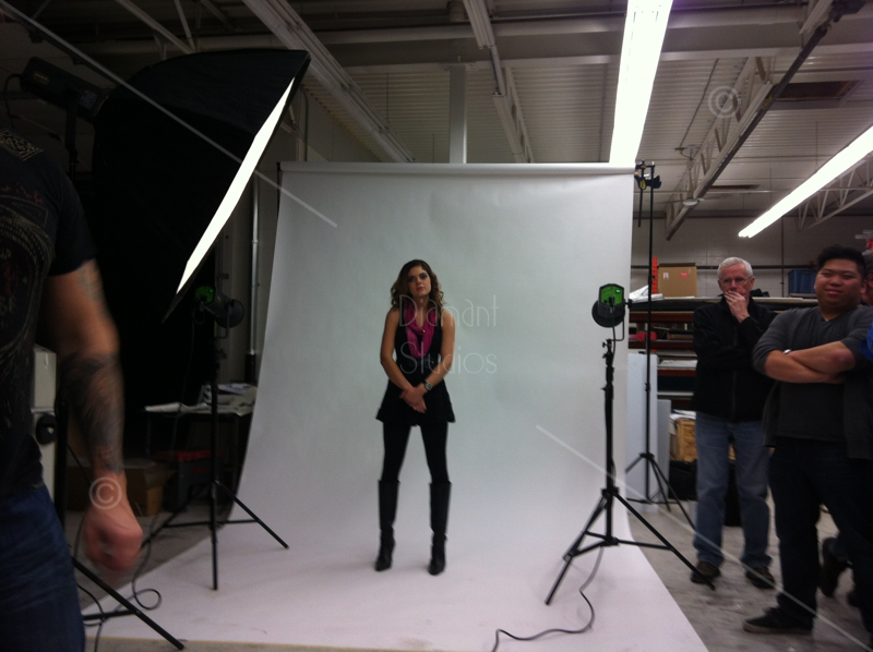

One white background setup:
IMAGE: http://diamantstudios.ca/Gemeines/Bilder/White_BG_setup_800px.jpg
That one isn't my setup. I shot that pic at a PhaseOne workshop, and I asked the photographer about it. He said he metered the subject for f/8 all around (meaning the octa –main light– was set to f/8 and the reflected light from the background –metered behind the model's hair– read f/8 too). As you can see, he was using two monolights to light the background; now, a meter reading for the background wouldn't read f/8, mind you, but at least f/16.
That setup yielded images like these:

Yes, there's a certain amount of 'rim lighting' on the model; so, to avoid that, either move her more towards the front (the paper width might be a limitant in this case), or flag her with two large sheets of black cloth or foamcore –one on each side and a wee bit behind her, just outside of the frame.
BTW, that was a 107" roll of paper.
