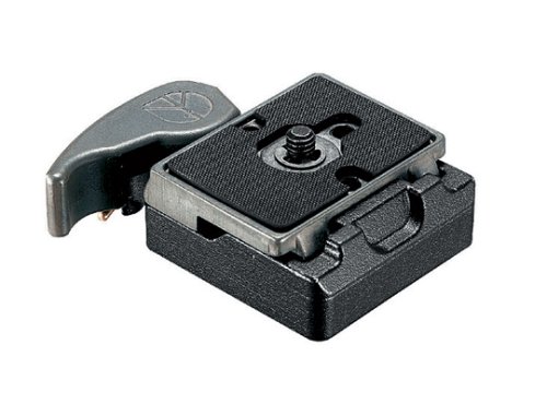

It's funny when I was reading Tom's post, i was picturing the RC0 system by Manfrotto/Bogen (those big ugly hex plates)
IMAGE: http://www.objectif-bastille.com/WebRoot/Master/Shops/objectifbastille/Products/30488/30488.jpg
up until he got to the part about it not using any kind of "speed plate" in which case I have no idea, unless it was the old 1/4" threaded screw. But if so,. then why no just screw on an Arca clamp?
I had a soft spot in my heart for the much smaller and also a good deal more ubiquitous Manfrotto RC2 (small plates about the size of a small Arca lens plate)
This ones been adopted/copied by a number of manufacturers as well.
IMAGE: http://static1.discoverdigitalphotography.com/wp-content/uploads/2013/why-use-a-quick-release-system-when-using-your-camera-on-a-tripod/Manfrotto-323-RC2-Rapid-Connect-Adapter-with-200PL-14-Quick-Release-Plate.jpg
