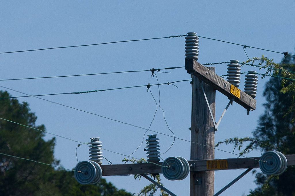

Photographically uninspired, but a good example of what is achievable with the 70-200 f/4L IS at f/5.6 with B+W brand CPL. Focus is on the topmost wire, close to the insulator, this is 1/4 of the frame area...
IMAGE: http://i69.photobucket.com/albums/i63/wiltonw/POTN%202013%20Post%20Mar1/IMG_9956_zpsbjrqrhlr.jpg
Photo has no lens corrections (for chromatic abberations, etc.) I even left in the dust (no it is not a distant UFO!)

That is the sharpness I was hoping for with this lens. I've sent it back to Canon twice. Both times they said it was fixed.
