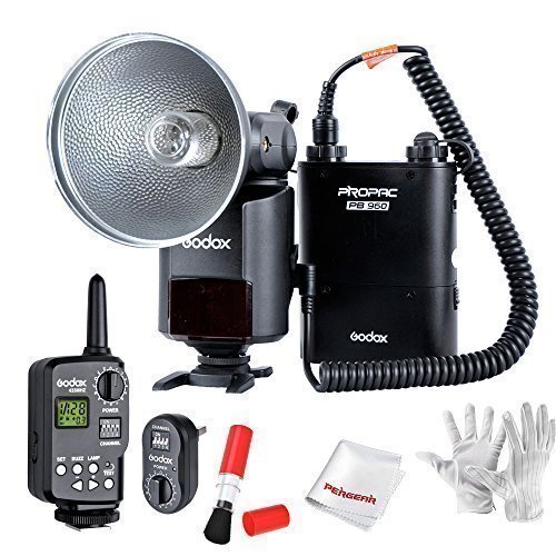

Just to make sure I got this right: the MK1 kit (pictured first) is capable of HSS but does not include the transmitter required for HSS. The MK2 kit (pictured second) has the transmitter that enables hss included, right?
MK1 kit
IMAGE: http://ecx.images-amazon.com/images/I/51695-NQA0L.jpg
MK2 kit
IMAGE: http://ecx.images-amazon.com/images/I/51SBJ7lnpYL.jpg

abdul10000 wrote in post #17949652 (external link)
That's correct.
If you really don't need or want TTL, you could buy the AD360 (i.e. mark I) a $45 transmitter (the X1T-C for Canon, X1T-N for Nikon) and a $20 receiver (XTR-16). You wouldn't be saving much money, however, and you would have the added bother of a small receiver that needs to be plugged into the side of the flash.
Owen.
dmward

Right.
Another option for the Mk1 is to get the XTR-16. Tt replaces the FT-16 and permits it to work with the X-1 which is an FP-sync capable trigger.
I think, you'll have to confirm, that the XTR-16 permits setting the MK1 to H mode from the X-1. With another FP-sync trigger, such as the YN-622, the AD360 MK 1 has to be placed into H mode by pressing buttons on the flash unit.
