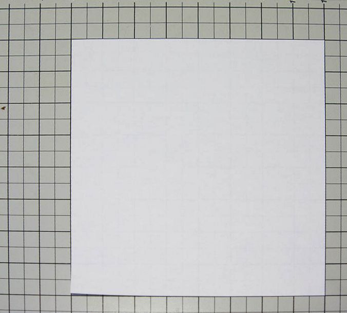

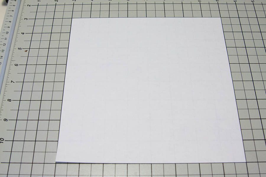

If you shoot without a shift-capable lens, you can use postprocessing software to correct the converging vertical lines. Be aware, however, that you may introduce apparent aspect ratio error by doing so. I just photographed a nice square piece of paper on a rule background (paper cutter). (Think of the paper as a 8' x 8' wall being photographed when your camera and lens is not perfectly level to the ground)
The first shot is as taken in the camera and imported into Lightroom.
IMAGE: http://i69.photobucket.com/albums/i63/wiltonw/Principles/IMG_9985_zpsn0tqepa7.jpg
Then I used Paintshop Pro and its Perspective Correction feature to straighten the converging verticals.
IMAGE: http://i69.photobucket.com/albums/i63/wiltonw/Principles/IMG_9985%20perspective_zpszbrjwnhu.jpg
Note that the paper in the photo now looks like its inherent square shape
But not that the photo is no longer 1.5:1 in aspect ratio. It only frames a 11:9.5 area, although the square item in the photo looks correct!
The corrected perspective also reveals the importance of your lens selection, to try to avoid pincushion distortion commonly seen in zooms at the WA portion of their FL range. In this case, I shot with a Tamron 28-75mm lens at 28mm f/5.6. I know better than to use this lens for real estate if there are strong visual lines! (I do have a 24mm Perspective Correction lens from Olympus, which I use on an adapter when shooting with Canon dSLR body.)

I used Paintshop Pro simply because I have not upgraded my computer to the Lightroom 5. LR5 has the Upright tool (in lens corrections) and can resolve converging verticals. I mentioned apparent distortions caused in the correction of converging verticals because it is a generic result, not unique to the software I used, but is something that even Adobe points out in its video tutorials. Adobe has a variety of options in LR that you can turn on/off to address different forms of resultant distortions, some of which are designed to 'make the photo more pleasing to the eye' but in itself can allow varying degrees of distortions to exist in the correction process. If I had an active business in real estate photography, I certainly would have upgraded my computer software long ago, to use perspective correction in LR6 (and later).
