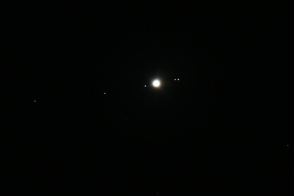

It's funny you mentioned Jupiter. That's the only other thing I really messed around with last night. Last night was the first time I've ever seen it through a telescope. And I've never seen Jupiter's moons through a scope. I was blown away! I realize there is nothing technically good about this image, it's just a single image straight out of the camera - except for a slight crop. I'm looking forward to becoming familiar with the best methods and techniques for shooting and stacking images, but for now, even THIS excites me:

Celestron
8,641 posts
Likes: 406
Location: Texas USA
Apr 17, 2016 20:52 as a reply to  @ Phil Light's post |  #6
Gosh when you went all out you do it well !! Great scope, take your time and learn it well , learn constellations well, learn about DSOs' ( deep space objects) . You are starting a trip down a great road of astronomy . Never be afraid to ask anything you need help with. Clear Skies , Dark Skies !!
