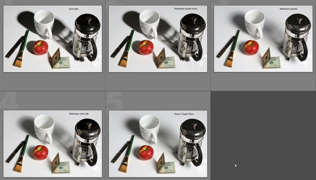

I took the liberty of taking your five comparison shots and making a single composite in order to make it easy for everyone to visualize the differences between the panels side by side. I hope you don't mind; let me know if you mind and I will remove this post.
IMAGE: http://i69.photobucket.com/albums/i63/wiltonw/POTN%202013%20Post%20Mar1/dt_zpsraytuwwm.jpg

Thanks, Wilt, that looks perfect.
