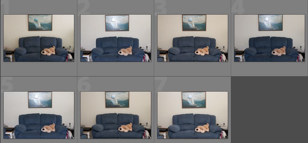

I just thought I would offer this 40D series as a 'control' against which to judge 70D and 80D...
For reference: Scene is my family room, the couch is about same as 18% grey tonality and the stuffed animal subject is about my skin tone tonality.
The test series is comprised of these shots (all ISO 400), flash is Metz 54MZ-4, roughly equivalent to 580EXII
  1. Ambient light only, Evaluative metering pattern, Av mode, 1/60 f/2.8
  2. Auto photosensor mode flash direct, M mode, 1/200 f/2.8
  3. Auto photosensor mode flash bounce flash, M mode, 1/200 f/2.8
  4. ETTL Evaluative mode flash direct, M mode, 1/200 f/2.8
  5. ETTL Average mode flash direct, M mode, 1/200 f/2.8
  6. ETTL Evaluative mode flash bounce flash, M mode, 1/200 f/2.8
  7. ETTL Average mode flash bounce flash, M mode, 1/200 f/2.8
IMAGE: http://i69.photobucket.com/albums/i63/wiltonw/Principles/40D%20flash%20compare_zps3w4kgu5l.jpg
One can see that with flash Evaluative it is a bit darker on the direct flash and bounce flash shots, but both are not much different from ambient-only shot!
I suggest a comparable series, when folks shoot tests with the 70D and/or 80D, to judge flash exposure accuracy.
