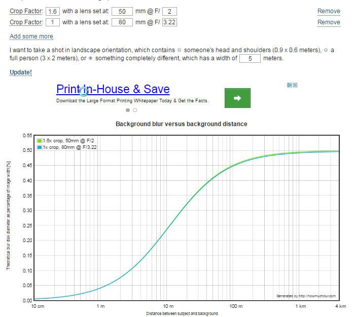

Apr 23, 2016 09:15 |  #9
TeamSpeed wrote in post #17981784 (external link)
You can tell the difference between ff and crop when framing identically between the two of the same subject at the same aperture, that is a big draw for many. Also depending on which crop, you will be able to see sharpness differences between the two using the same glass. I don't think the differences are really quite that trivial.
But one needs to ask yourself, "...but practically speaking, under what circumstances will you actually be able to SEE the DOF difference, to intuitively KNOW 'shot by APS-C vs. FF'?"
The DOF difference which is noticed is when using a lens wide open... since you cannot make an 80mm f/1.4 lens (if that lens existed) on FF perform like a 50mm f/0.7 lens on APS-C (since that max aperture lens does not exist).
But if you use the f/80mm lens at f/3.2 on FF and then switch to 50mm f/2 on APS-C, you will not see any difference! (In this chart, I used f/3.22 simply to visually separate the blue line from the green line on the graph; if I had entered 80mm f/3.2 the lines are perfectly coincident, showing same DOF and same far field blur magnitude.)
IMAGE: http://i69.photobucket.com/albums/i63/wiltonw/Principles/DOF%20diff_zpsckes4f9m.jpg
Inherently you will not be able to visualize 'shot with FF' vs. 'shot with APS-C' as a result.
