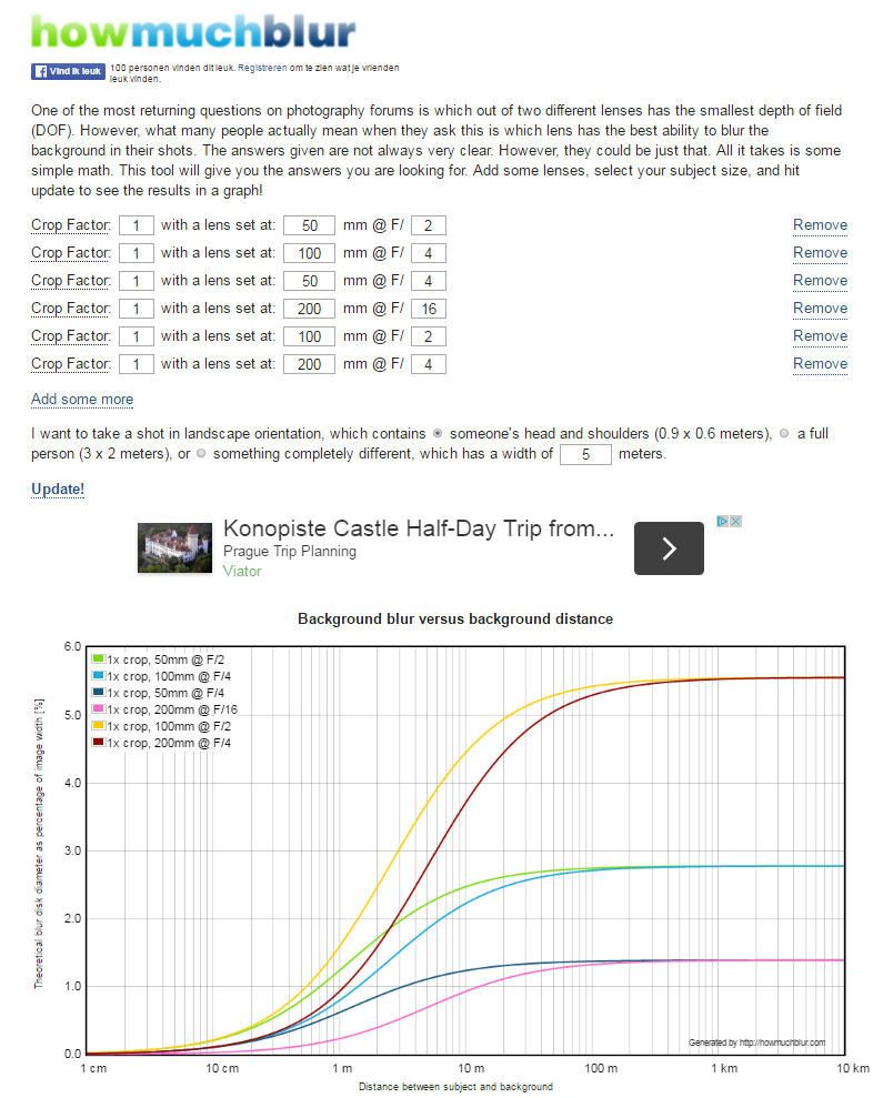

Some critiques
  1. Unfortunately, 'compression' is a term usually associated with 'telephoto compression' in which distant objects seem to be brought closer to the subject, because their apparent size is magnified (by camera position, relative to the distant object vs. your subject). You risk confusing the beginner with using that same term relative to DOF discussion, when it is not applicable and normally not part of DOF discussions.
  2. Your statement, "as we walk back and zoom in, keeping our subject the same size within the frame, the background has been brought closer" is indeed true, but not in the context of what is 'in focus' vs. 'out of focus'. Relative size ('brought closer' vs 'moved back farther' is a characteristic of 'perspective', not 'DOF'.
If we look at a variety of FL and how BLURRY the background will be, we see that with varying FL the degree of blur will be THE SAME, assuming the diameter of the aperture (as measured in mm) is the same. In this chart, all apertures are 12mm in diameter (FL / f-stop)
IMAGE: http://i69.photobucket.com/albums/i63/wiltonw/Principles/OOF%20blur_zpsv1koyaav.jpg
Per the above graph, in the 'distant background' (past 1km) the blur magnitude is the same, but in the near background (e.g. 1m - 100m) the blur magnitudes do differ, with -- counterintuitively -- the SHORTER FL more blurred than the longer FL lenses.

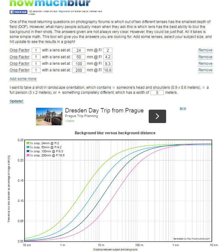

    3. You state, "the image will appear to be more out of focus when zoomed in". Again, to avoid confusion in use of terms, most folks think of 'zoomed' as pertaining to FL. The image is NOT 'more blurred' due to FL, per se, as the blur chart proves. The DOF is shallower 'when the subject occupies a larger percentage of the frame' at the same f/stop, but the farfield blur magnitude is related to the aperture diameter.
IMAGE: http://i69.photobucket.com/albums/i63/wiltonw/Principles/DOF%20farfield%20blur2_zps2np2gzee.jpg
Rows 3-6 of this table represents the same information presented in the first grapyh; Rows 8-14 of the table represent varying combinations that have DOF vs. farfield blur magnitude.
IMAGE: http://i69.photobucket.com/albums/i63/wiltonw/Principles/DOF%20v%20farfield%20graph2_zpscivwkkdy.jpg
The above table and chart show that DOF zone depth is not necessarily directly related to farfield blur magnitude. And neither are directly related to FL.
  • At the same f/stop, the DOF zone is related to the size of the subject in the frame
  • At the same aperture diameter (millimeters), the farfield blur magnitude is the same

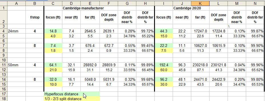

The hyperfocal distance is actually the distance that for that focal length and aperture combination will give the maximum depth of field. This is also the one situation where you get the classic 1/3 - 2/3 DoF split around the focal distance. So for the Hyperfocal distance your 2/3 DoF behind the focal distance will take you to "infinity" and your 1/3 in front is also pretty simple to figure out. So you actually have a DoF from 1/3×HFD to Infinity. In the section that you talk about HFD you mention the 1/3 2/3 split at HFD, then proceed to quote figures in your example at half HFD. If your HFD is 30m then your DoF will be 20m to infinity, not 15m. For a 6m HFD you will have 4m to infinity, not 3m.
I have a problem with the 1/3:2/3 split of DOF zone, as it is an urban legend, and is only true at ONE specific distance (not at the Hyperfocal distance):
In the case of the 50mm lens at f/4 (and assuming 20/20 visual acuity of the viewer), Hyperfocal distance is 58m, and the closest 'in focus' distance is 29m (1/2 the Hyperfocal), and the far distance 'in focus' is 65616m away, IOW...
  • the DOF zone is 65587m deep,
  • the near distance in focus is 29m in front of the Hyperfocal point or 0.00044% IN FRONT
  • the far distance is 65529m behind the Hyperfocal point, or 99.9116% BEHIND
IMAGE: http://i69.photobucket.com/albums/i63/wiltonw/Principles/Hyperfocus%20DOF%20split%20myth_zps9zdmfr37.jpg
[edit: An observation made just a moment ago (5/20/2016), as I looked at hyperfocal distance vs. the focus distance at which 33:66 distribution is true...
for 20/20 visual acuity assumption, the 33:66 DOF split distance is about 31-33% of the Hyperfocal distance!]
