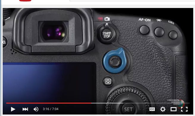

- Simple method of AF point selection. With Nikon there is a round, quarter-sized selector button on the back of the camera. You move it around to select the AF point in your viewfinder. It is a simple, one thumb movement process. With my 7mdk2 I have to press the AF selector button, THEN fiddle with the little joystick-like knob on the back. It is a two step process. How do I set this camera to make it a one step process?

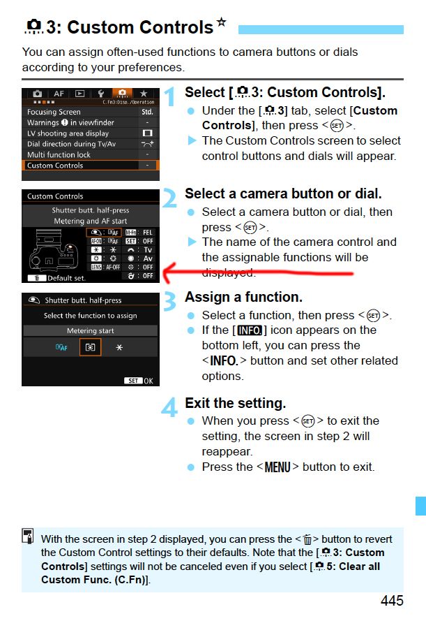

There are two things that can help you. The multi controller that you can program to move the AF points around and the AF area selection lever which will select the type of AF. Single, expansion, etc.
The centre button is the multi controller and the blue is the AF lever.
You can see them up in the custom controls. Pg 445.
You also have to activate them. Pg 124
