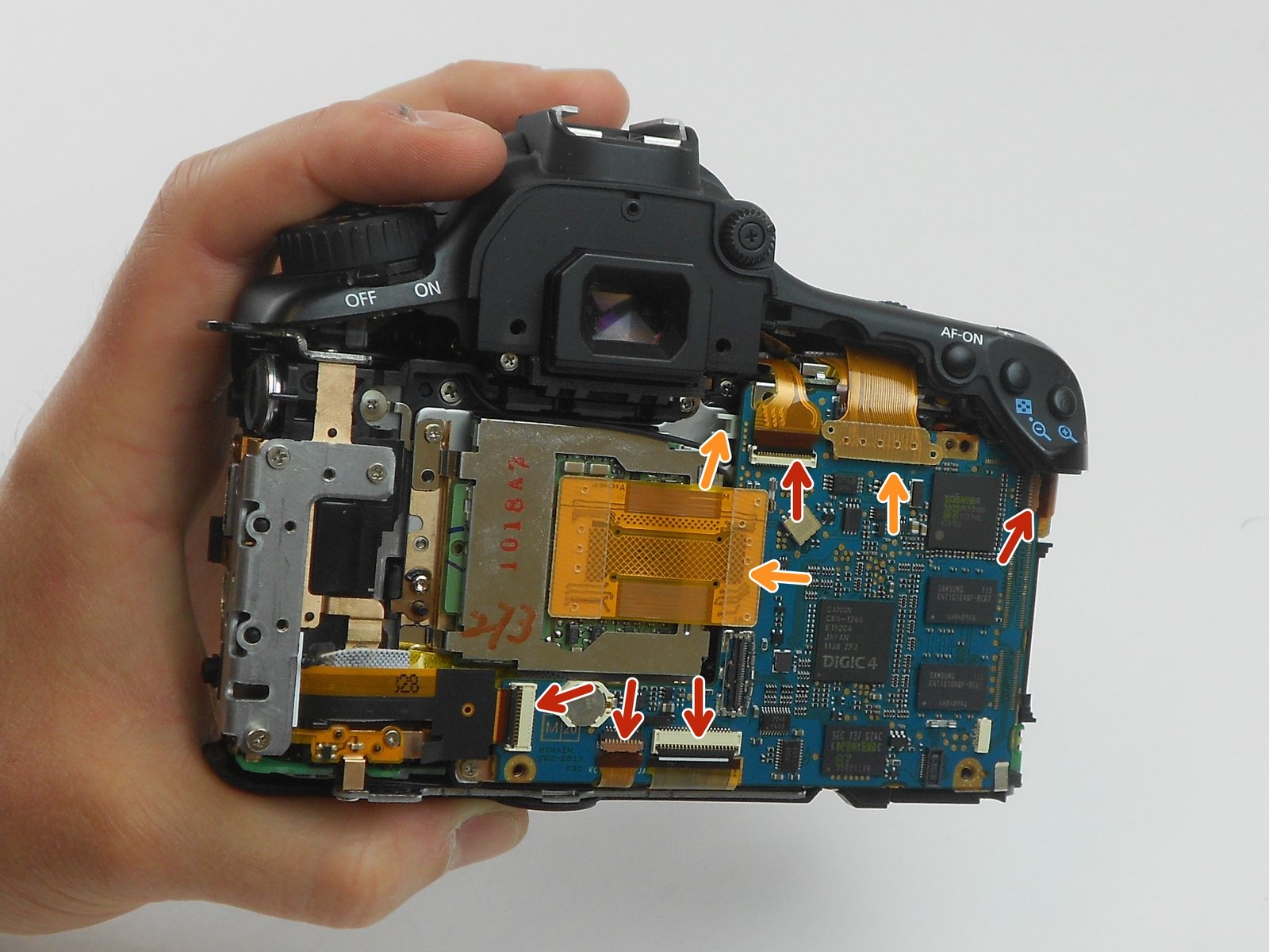

My memory and watching the history of the cameras has said the 1D cameras has always been dual processors and an independent processor for each meter and AF functions = 4. The 7D was dual processors and another that was unspecified for metere/AF functions. The 5D has always been single processor for image and another single for AF/Metering... except the 5DS which has dual processors.
Edit: I do believe the XXD and rebels use a single processor for imaging but they use a generic processor for the AF function.
This is the 5D3 https://static1.square​space.com …Main-PCB.jpg?format=2500w (external link)
The elpida chip is a memory module used in all the canon cameras but I belive elpida went bankrupt in 2012 or 13 something like that. Not sure where the source is. The other chip labeled "F74965A" is the AF/metering processor. So the 5D3 used a digic 5+ and a generic metering/af module that was used the same in the 7D, 60D... etc. The 1DX at the time used dual digic 5+ with a digic 4 for AF/Metering.
I did alot of research awhile back and this is what I uncovered.
For the 5D4 to use a 6+ for imaging and digic 6 for af/metering then this is why the 5D4 AF works better. Much more powerful processor handling the AF functions. This is a step closer to the 1D line. The 7DII I know for a fact uses the dual Digic processors for imaging but I thought uses the same F74965A chip for AF/metering
The xxD line and rebels I thought all use just a single processor for all functions.
what do you mean by single processors for image and another single for AF/metering? isn't that considered dual processors? or do you just mean "dual" = two identical processors?

ilumo wrote in post #18135644 (external link)
What I mean is teh rebel line and the xxd was always using a single processor to handle the imaging procesing and the AF/metering functions all at the same time. This could be wrong information though look at the 60D:
https://d3nevzfk7ii3be​.cloudfront.net/igi/rS​JGg3hHCTYBkass.huge (external link)
I haven't ever been able to figure out what the toshiba module is for. The other modules are memory chips.
The 5D3 uses a Digic 5+ for it's imaging and the FP module for it's AF and metering functions. When a camera company says "this has dual processors" it's referring JUST to it's imaging processors. The 1D series, 7D series and the 5DS all uses dual imaging processors to handle either the super high megapixel or the super fast framerate. The 1D has always had seperate processors in addition to the imaging processors to handle each metering and focusing. The 7D used dual digic 4 processors and an unknown processor to handle both AF/Metering = 3. The 7D2 appears to use dual digic 6 imaging processors and a spartan 6 processor to handle it's AF/metering. The 5D4 uses the digic 6+ for it's imaging and another digic 6 for it's metering/AF = 5D4 would have faster AF/metering computing.

gjl711 wrote in post #18135570 (external link)
I take that back. both a 6 and a 6+. I was expecting them to look more or less the same.
http://www.lense.fr …k-IV-Circuit-Board-02.jpg (external link)
Ah, but in that drawing/schematic, where you see a Digic 6 written on the IC, that is actually a memory chip, it is a Micron Elpida IC. I don't trust that circuit board drawing, as we have a real bonafide teardown showing something else.
EDIT: I didn't see Talley's response, but we are in agreement. I see only one processor on the motherboard, as I run each chipset through google as best I can. Also Micron picked up the Elpida line not too long ago, it seems.
