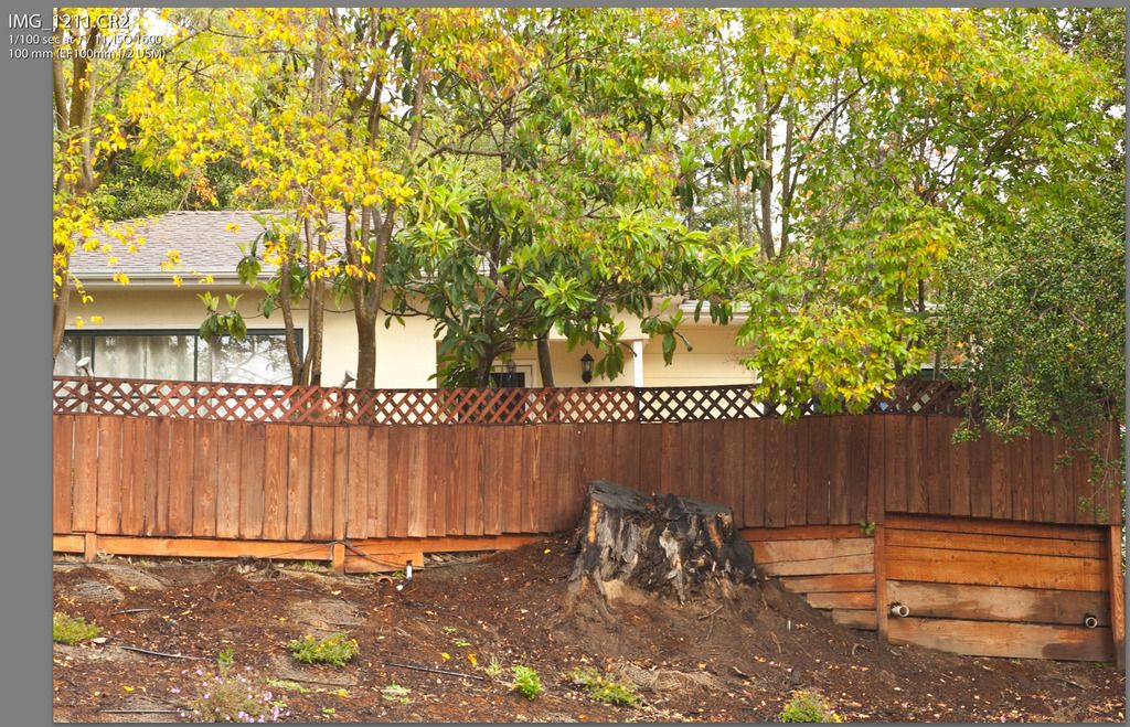

#3 gets only the background in fine focus, in theory. But here is a photo, focused at Infinity and the house across the street from me is about 100' to its front door...
IMAGE: http://i69.photobucket.com/albums/i63/wiltonw/Principles/IMG_1211_zpsfjbkoeyf.jpg
This test appears to show that even with a subject at 100', focus at Infinity is not necessarily a bad thing! If my wife is recognizable, and the observatory and mountain are of significance, it seems the focus at Infinity works well enough that my wife is still recognizable in the photo, even if not 'acceptably' sharp to a viewer with 20/20 vision. After all, the 'manufacturer standard' DOF zone says 114' to Infinity is 'in focus'!
