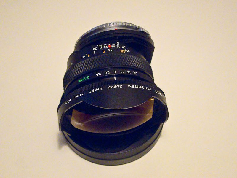

A 24mm FL perspective correction lens, with shift movements at a minimum, to avoid converging verticals.
Here is a photo of the Olympus 24mm shift lens, shown in shifted position. Nikon has a very nice one, too.

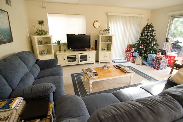

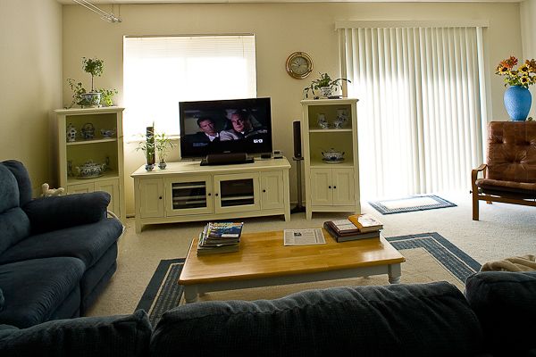

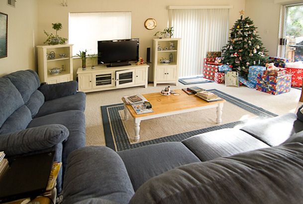

I don't routinely shoot real estate for the purposes of promotion of homes being listed for sale. I have done architectural interiors and exteriors of buildings that have undergone extensive renovation work. Occasionally I might pull out 20mm lens, but not often. My own family room, I prefer the rendition of the space by 24mm.
Shot on APS-C with 11mm (18mm FF equiv)
IMAGE: http://i69.photobucket.com/albums/i63/wiltonw/Shift-2.jpg
11mm on APS-C corrected for convergency in post
IMAGE: http://i69.photobucket.com/albums/i63/wiltonw/Shift-3.jpg
24mm PC
IMAGE: http://i69.photobucket.com/albums/i63/wiltonw/Shift-1.jpg
