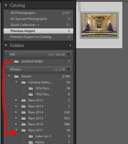

The catalogue system takes a bit of getting used to. Be sure you are careful where you place it when you first open it. If you import folders make sure you move them around and rename them within LR. If you import a folder off the desktop and then move that folder off your desktop it won't be able to find it.
Here is an example of a folder I just imported. When I drag it into the 2017 folder it will disappear off the desktop and go where the catalogue is stored. You can access all those folders and open images with DPP, PS or any other and editing software and edit. It won't effect your LR adjustments. Just don't move them from that location, only within LR. Later you can always change the catalogue location very easily if you have to.
This is how I set it up but there are many other and better ways for advanced searches, etc.
IMAGE: http://i33.photobucket.com/albums/d74/Zenon1/Lightroom/Untitled_zpsonuoqzl5.jpg~original
