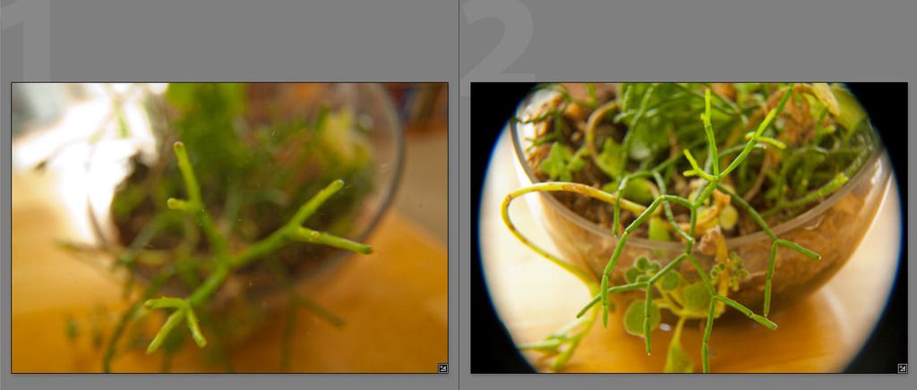

'no issues', wrong! A lens designed for coverage of the APS-C frame does NOT COVER necessarily the full area of the larger (24mm x 36mm) FF size!
Here is a pair of shots taken on FF camera, with Tamron 11-16mm DX and with Canon EFS 17-55mm lens at 55mm...both lenses designed for the smaller APS formats and mounted on a 13mm extension tube.
The Tamron was at 16mm, while the Canon was at 55mm...the longest FL of a zoom tends to have the largest image circle size, yet the Canon at 55mm does not fill the FF frame
IMAGE: http://i69.photobucket.com/albums/i63/wiltonw/APS%20lens%20macro%20FF_zpsuhztexnk.jpg

Jan 17, 2017 12:54 as a reply to  @ Wilt's post |  #7
oh, yeah... I missed the obvious!
