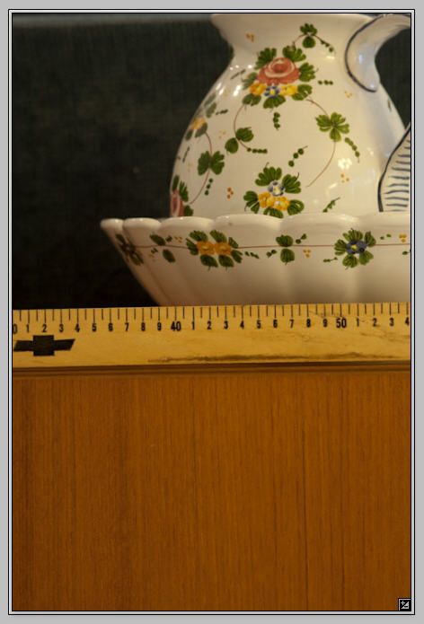

Canon lies, just like the rest. I recall when I first purchased my 20D, I had a 70-200mm zoom and a 17-85mm zoom, and the 70mm indication on the two lenses did not match the FOV!
With the 70-200mm mounted on 5D, at a distance of 119cm (46.85") the camera should see 38.4cm along the short dimension of the frame. What it sees is about 30cm, as seen here:
IMAGE: http://i69.photobucket.com/albums/i63/wiltonw/POTN%202013%20Post%20Mar1/70mm%20FOV%2070%20200_zpsd5eu9bwx.jpg
...which is the FOV of 88mm FL.
Here is the Canon 100mm lens at the same camera position. It should see 26.16cm, it sees:
IMAGE: http://i69.photobucket.com/albums/i63/wiltonw/POTN%202013%20Post%20Mar1/100%20FOV%20100_zpsvrlmscoh.jpg
...about 24.25cm, which is about 107mm

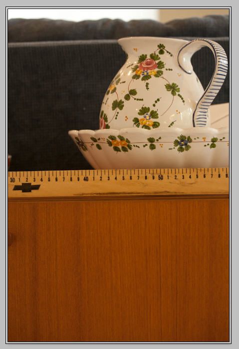

Lastly, 100mm on 70-200mm lens, which also should see 26.16cm but sees 24.25cm:
...at least that is consistent with a dedicated 100mm lens from Canon
