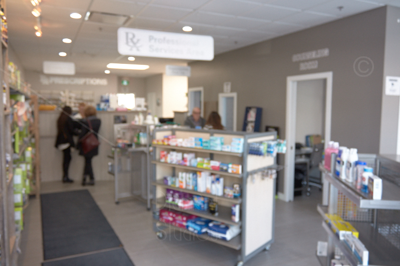

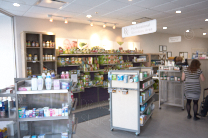

Hmm, the location is quite small (which might be an advantage as I might be able to use flash for everything):
IMAGE: http://diamantstudios.ca/Gemeines/Bilder/Hi-key_loc--1.jpg
IMAGE: http://diamantstudios.ca/Gemeines/Bilder/Hi-key_loc--2.jpg
The ambient lighting in there is abysmal and there's strong competition from daylight pouring through the window and entryway in terms of colour. By the window/door, the meter reads f/4 @ 1/125 s, ISO 400. In the middle of the place, the meter reads f/1 (yikes!) @ same shutter and ISO.

The two images posted the angle of view is away from the windows into the darker portion of the store.
To get the brighter background you need to be shooting in the opposite direction.
Then set the exposure to over expose the background about 1 EV and light your subject to proper exposure that is below the background exposure. Done.
