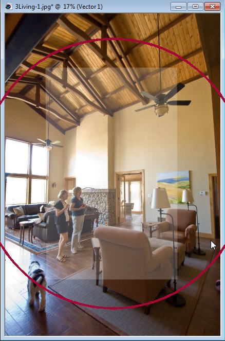

The focal length of the 300mm f/2.8 on your 7D is 300mm.
The Field of View is the only thing that changes (we'll simplify by ignoring the DOF difference seen in an 8x10 from your 7D vs. a 6D). The crop factor multiplier arithmetic only says
"100mm on APS-C is like using 160mm on FF" (100 * 1.6 = 160)
Your 7D (approx) 15mm x 22.5mm sensor is 1/1.6 the size of the 24mm x 36mm sensor of a 6D, and for that reason it only captures 1/1.6 % of the horizontal and the vertical dimensions captured by the larger sensor. This point is illustrated with this
IMAGE: http://i69.photobucket.com/albums/i63/wiltonw/cropvFF_Imagecircle.jpg
in which the whitish rectangle represents the smaller 15 x 22.5mm sensor of the APS-C camera

sploo wrote in post #18335219 (external link)
This also explains the point of EF-S lenses - they can be physically smaller because they don't need to project an image circle large enough to cover an entire full frame sensor (only the smaller crop sensor). Conversely, using an EF lens on a crop body "wastes" some of that projected image circle, as the sensor never "sees" it.
...the EF-S lens image circle is depicted via the red circle of my earlier illustration
