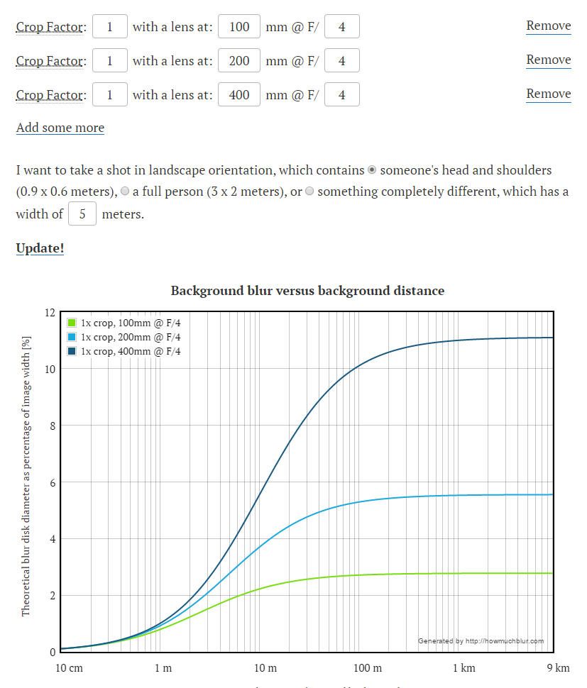

Jun 10, 2017 00:03 |  #9
If you are shooting to a specific frame-filling of the subject, you will not achieve more intense blur with FL alone.
At the same framing of the subject, FL does NOT MATTER for DOF at the same shooting aperture...
  • 100mm f/4 at 10' has 20/20 vision DOF zone of 0.25'
  • 200mm f/4 at 20' has 20/20 vision DOF zone of 0.25'
  • 400mm f/4 at 40' has 20/20 vision DOF zone of 0.25'
...same framing, same DOF zone, and same far background blur, you will need to shoot with a larger diameter aperture in order to increase the intensity of blur in the background. So using the same apertures as used above for DOF, here is how the larger aperture (400mm f/4 = 100mm aperture) outdoes 100mm f/ 2 ( 100mm / f/2 = 50mm aperture):
IMAGE: http://i69.photobucket.com/albums/i63/wiltonw/Principles/blur1_zpse9qcq64q.jpg
And here are the apertures needed for 100mm 200mm and 400mm lense to have 'same far background blur' at the same subject framing:
IMAGE: http://i69.photobucket.com/albums/i63/wiltonw/Principles/blur2_zpsxnpo1zz2.jpg
