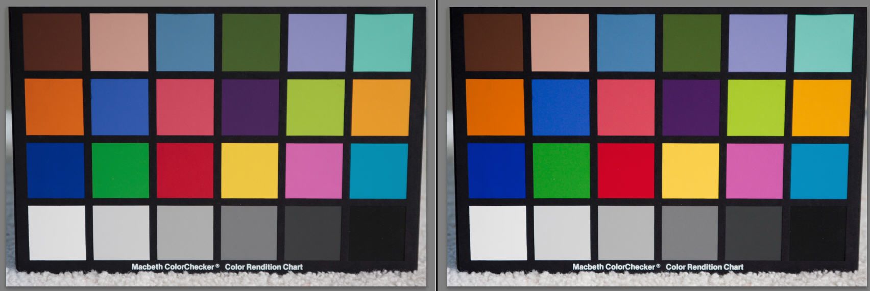

Nick5 wrote:
As Canon users we hear that the Adobe Standard profile has its goods and bads. Sure it's flat and a little lifeless and it is Adobe's conversion.
IMAGE: http://i69.photobucket.com/albums/i63/wiltonw/POTN%202013%20Post%20Mar1/compare%20cameracalib_zpsjxrozqjp.jpg
Certainly Adobe Standard is far from 'flat and a little lifeless'!
I have to admit that when I look at the real Macbeth Colorchecker and look at the two images and compare to the actual target, the Camera Faithful is closer to the real thing than Adobe Standard...Adobe Standard produces 'more electric' Orange and Orange Yellow, yellow Green, Blue and Cyan patches than the real target. (My Saturation setting by default is +20)
In trying out the setting with a real scene shot recently, while the difference can be seen, I cannot say that I prefer one setting over the other, however.

Wilt might I suggest that you try turning down the saturation to 0 when comparing the different camera profiles. Changing the profile can have a very significant effect on the saturation of certain colours. For example Landscape tends to boost greens and blues, while portrait tends to push the reds a little, for better skin tones. My default conversion now has Clarity 25, Vibrance 20, and Saturation 0. I much prefer the results of boosting vibrance over using the saturation slider.
If am not surprised that you are seeing saturation issues with the oranges and yellows, There is one aerobatic display team, that use wing walkers here in the UK that have an orange livery, and one of our preserved P51 Mustangs has a yellow nose, and they actually need to have the orange/yellow saturation reduced, even when using the least saturated profiles. Depending on the subject I find that the "flattest" profiles saturation wise is a toss up between Adobe Standard, and Camera Faithful. I used to muck about looking at different profiles, but mostly now I have settled on Adobe Standard, since it seems least likely of all of the choices to push any particular colour into clipping. When I have subjects that I know will cause issues I will often use the primary adjustments in the calibration section, pushing the red hue over to the right, and pulling back on the saturation seems to fix most of the bright paint colours that cause my problems.
When I'm working with these difficult colours I will often do a "Soft Proof" even for onscreen reproduction in sRGB, since the clipping I'm referring to is gamut, not exposure. This is especially useful now that I have a wide gamut monitor, when my monitor gamut was a bit less than sRGB it was sometimes very obvious that there were OOG colours. Some of the yellows and oranges that I have issues with will only fit in ProPhotoRGB, they show as clipped in just about any other colour space, including AdobeRGB.
Alan, in fact both Vibrance and Saturation (and, in fact, all settings except for Brightness and Contrast and WB settings) were set to Zero for the above screenshots!
