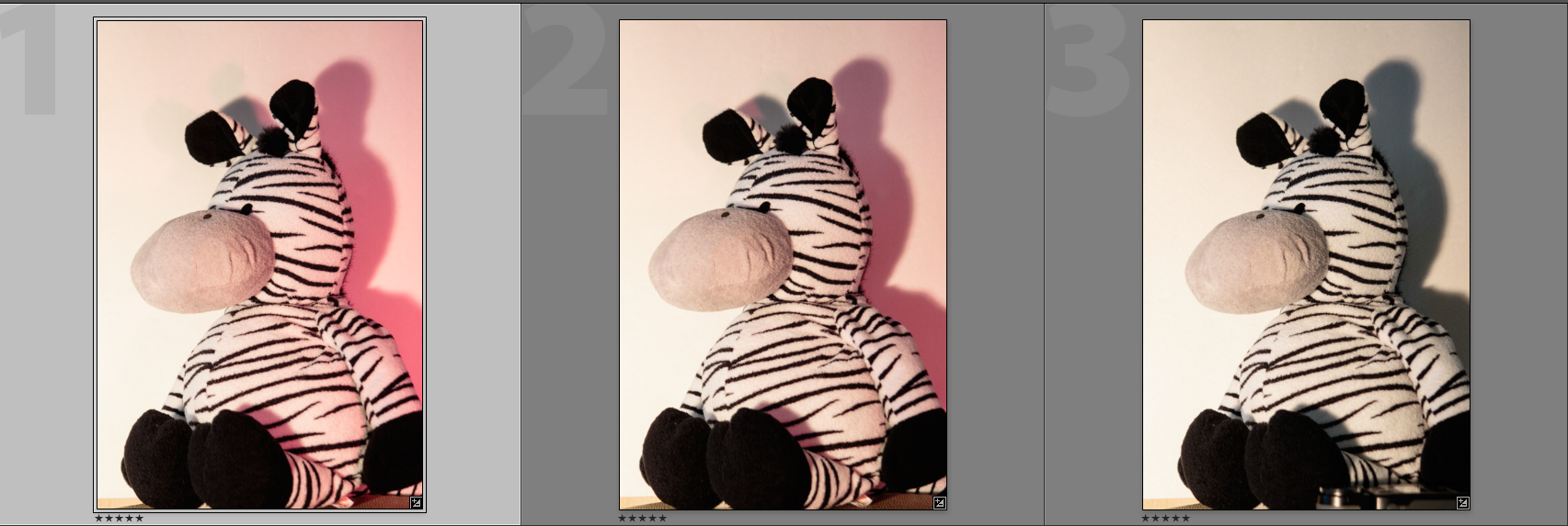

The extent to which the ambient light 'contaminates' the color temp of the light which you add via flash, is wholly dependent upon the proportion, and the degree to which the 'other light' differs from the flash...ambient at 3000K vs. flash at 5500K is different from colored gelled (e.g. purple) light vs. flash at 5500K.
I have not done extensive testing to quantify even warm ambient vs. flash but it is not difficult to simply do an experiment for yourself...after all digital exposures are 'free'! :lol:
Without having done a specific experiment to quantify, I would have suspected that if flash were +2.5EV more powerful than colored ambient, that would largely eliminate color light contamination. Having just done a test, Now I know I was wrong about a color light contamination!
In this test I shot only by modelling light with both sources at the same intensity and distance. But both heads had grids to limit the light spread angle; the right source started -2.1EV dimmer than the ungelled Left source (although at the same distance). Then I put a deep magenta Rosco 44 gel over the Right source.
  1. Shot 1 has Left > Right by 2.3EV
  2. Shot 2 has Left > Right by 2.7EV (Right source was moved farther back from subject to achieve this)
  3. Shot 3 is entirely illuminated by Left source
IMAGE: http://i69.photobucket.com/albums/i63/wiltonw/Principles/overpower_zpsxh7pdh2w.png
All shots set to same WB setting, and the shadow zone in shot 3 was used as the basis for eyedropper WB sample point.

Wilt wrote in post #18383730 (external link)
Boom!
