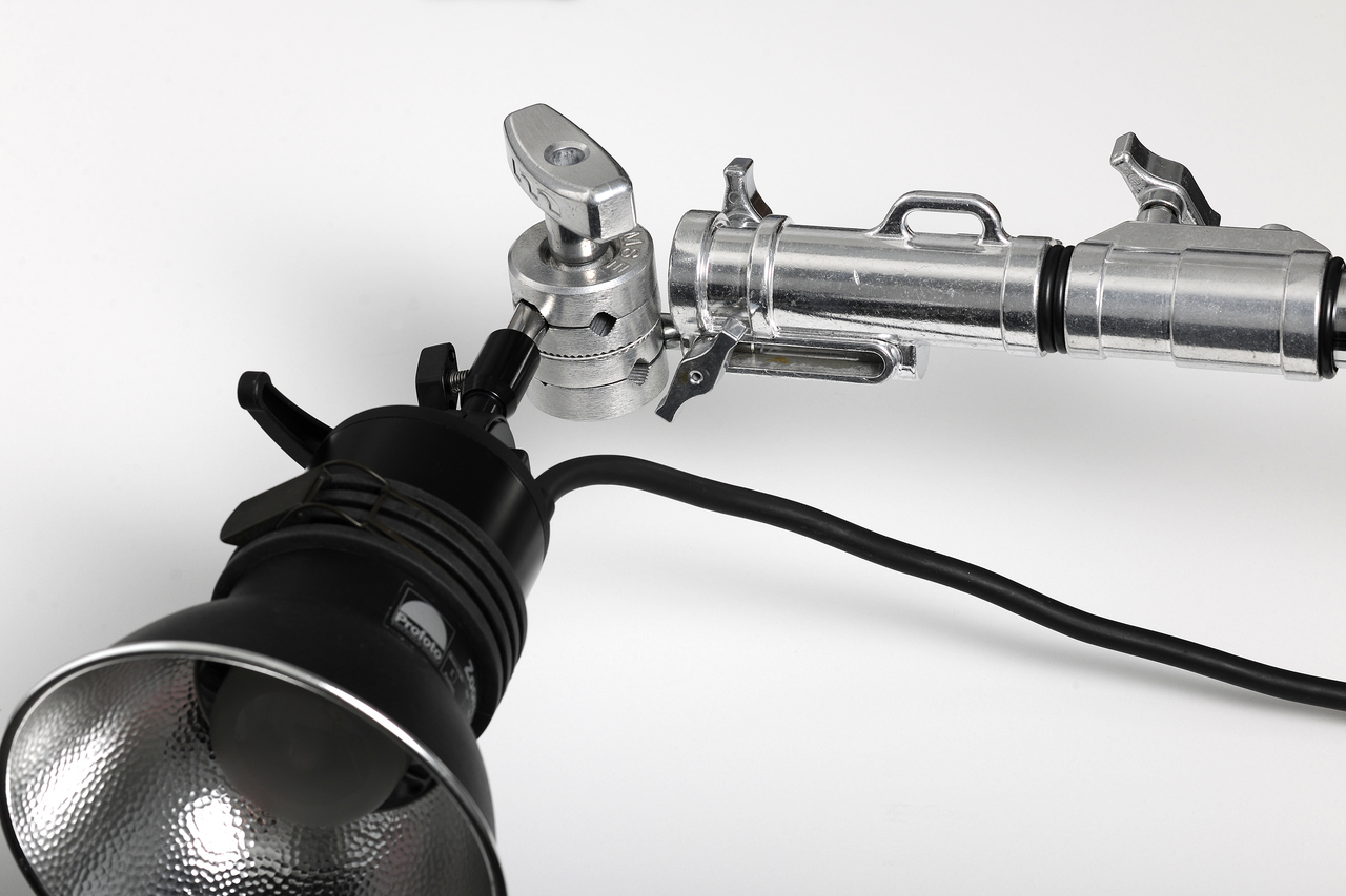

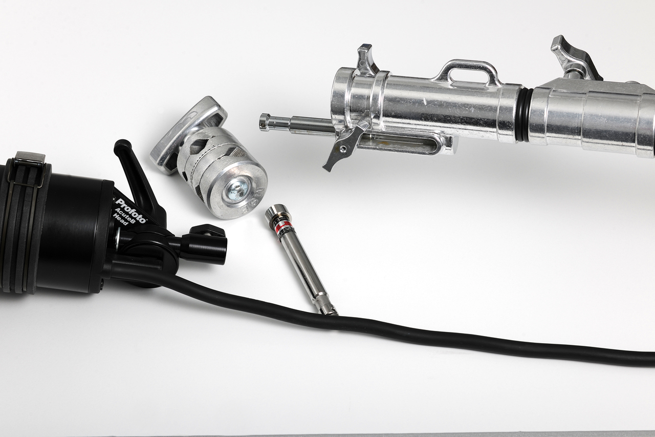

Exactly so. That retaining screw is the dumbest idea, but studio folk are stuck with it. My variant solution uses a gag and baby pin to create a right angle turn. This may protect the weak axis from rotational stress by the wind, or not. :)
IMAGE: http://makino.fi/rico/fm/gag2.jpg
IMAGE: http://makino.fi/rico/fm/gag1.jpg
