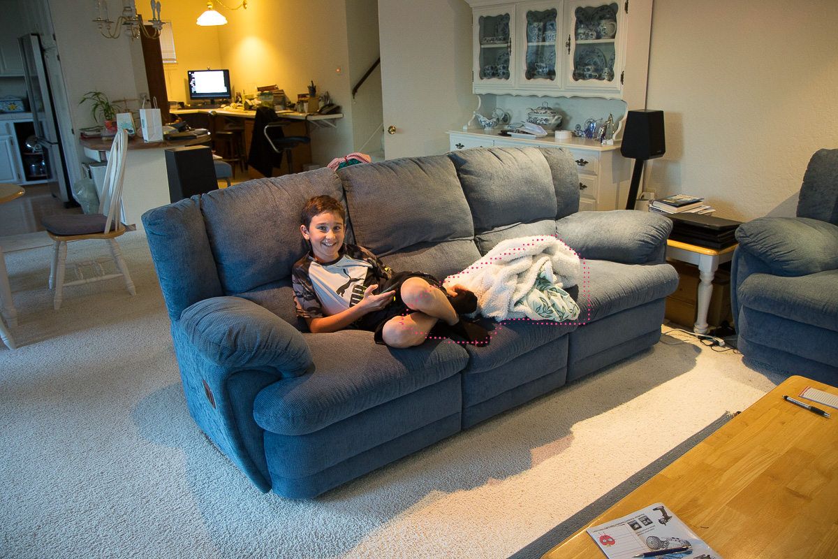

But when f/11 cannot be used because it is too dark and the Green Box camera refuses to use higher than ISO 800, like it just did in this photo of our eldest grandchild, cooling his heels at our home after school while waiting for his mom to pick him up...
IMAGE: http://i69.photobucket.com/albums/i63/wiltonw/POTN%202013%20Post%20Mar1/greenbox%20focus_zpsdnl5mnmh.jpg
and the red outline defines the AF points chosen by the 7DII in Green Box mode, a significant AF FAIL taken only moments ago, in response to your assessment!
Really? I wanted his knees and feet and blanket in best focus, really?!

Dec 18, 2017 19:39 |  #10
Wilt wrote in post #18521258 (external link)
You'd rate that shot a 'fail'??? In the unholy canon of third-party photography, that shot is up there with the top 10%.
Plus ... I think you just maybe set up that situation. ;-)a

Dec 18, 2017 19:51 |  #11
DaviSto wrote in post #18521310 (external link)
Yeah, it is a fail because no one would ever want feet in focus, although his face were certainly 'about center' in the frame. The fact that Green Box affords zero control of the AF zones to be used, whereas my approach (prefocus using my specified AF zones, before handing over the camera) assures me that even in shallow DOF photo situations the photo has a greater probabily of being properly in focus than leaving it to Green Box to decide. I framed the shot I wanted it, AF chose the zones inside the red circled area, and I pressed the shutter...
