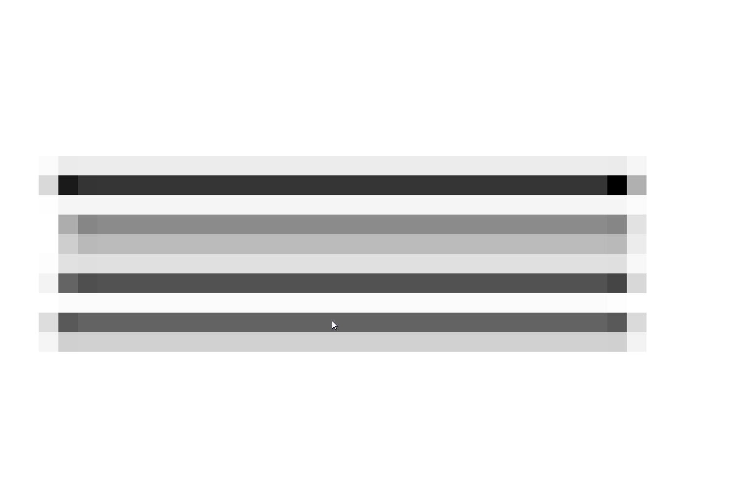

You are decimating the original image resolution by about 75% and leaving only 25% of the image resolution. A lot happens on that magnitude of reduction!

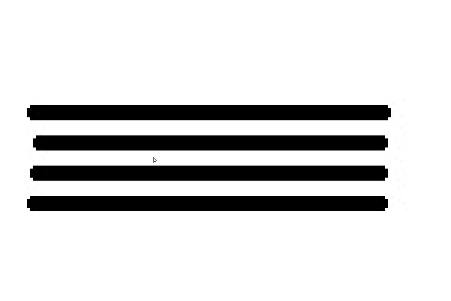

I used Microsoft Paint to create a small matrix of 150 x 100 pixels, then put four lines that were 5 pixels wide and separated by 5-pixel spaces:
IMAGE: http://i69.photobucket.com/albums/i63/wiltonw/Principles/high_zpszif5ib7c.jpg
Here is what the original stored JPG looks like, a screengrab with the original 150 x 100 pixels filling the screen, viewed in Paintshop Pro
IMAGE: http://i69.photobucket.com/albums/i63/wiltonw/Principles/highscreen_zpsbptoqy1m.jpg
Then I resized the image to 25% of the original, ending up with about 38 x 25 pixels in the image, and here is a screengrab of that filling the screen when viewed in Paintsop Pro
IMAGE: http://i69.photobucket.com/albums/i63/wiltonw/Principles/lowscreen_zpsvcxb5fug.jpg
