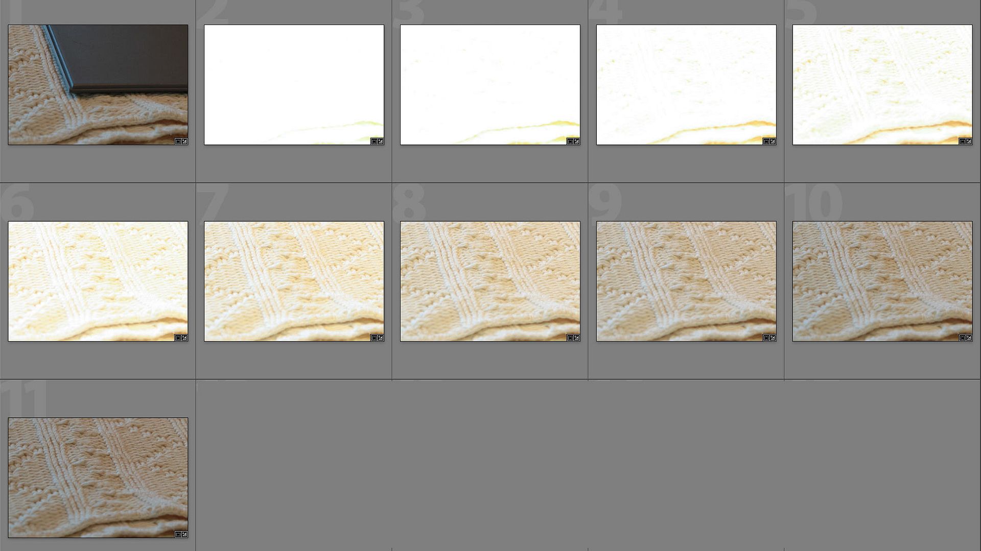

I just shot a cream colored blanket with hard source about 60 degrees above the blanket. First shot was gray card to establish color temp and baseline exposure (ISO 400, 1/45 f/5.6) All successive shots were white balanced to the LR eyedropper off the gray card. (For this quick'n'dirty example, I was in a poor environment of mixed light, with window light coming in as well as the overhead halogen and the intensity of the windowlight varied across the photo!)
Shot 11 and shot 1 were both at ISO 400, 1/45 f/5.6 baseline. Every other shot was in +0.5EV increments of increased exposure, altering shutter speed. I show a series of close crops of the full frame, so that you can see detail and judge where the detail of the blank becomes invisible...that is too much exposure! Based upon that, I would say that the limit of overexposure is about +2.0EV to +2.5EV above baseline gray card exposure.
