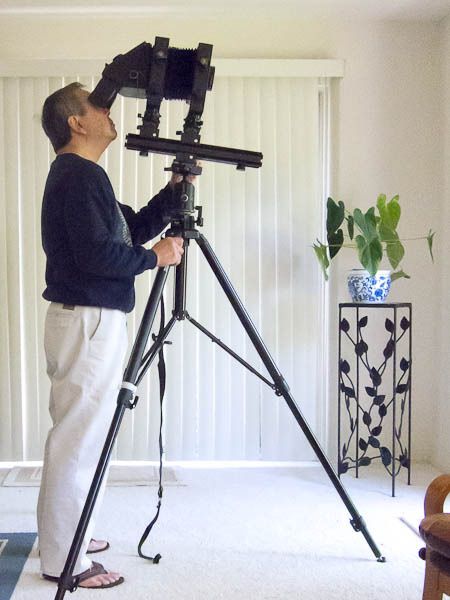

Just to be a bit argumentative...:-)
Why not use a right angle finder so that you can lower your head to look thru the eyepiece while the camera and lens are aimed at an upward angle?
The problem I see is that taller tripods need to have a bit more stiffness in them than a shorter tripod. More stiffness = larger diameter leg sections = more weight
which is bad when portability needs are there. I have a very tall (74") tripod, but is for 'studio use' and weighs just under 10lbs. without head!
IMAGE: http://i69.photobucket.com/albums/i63/wiltonw/Equipment/Reflexhood-4_zpsrypvjkpz.jpg
...and this is not as tall as it goes!
