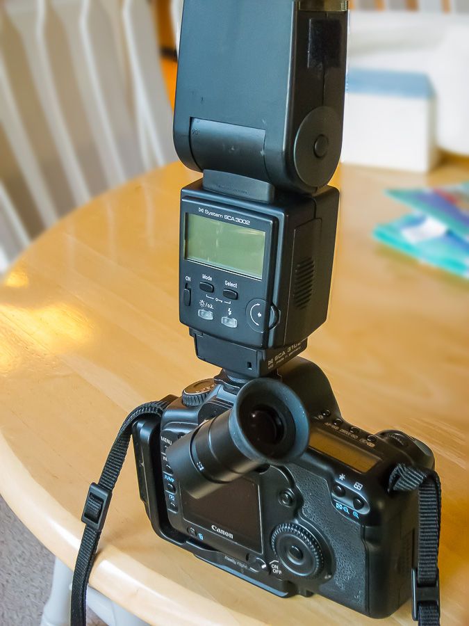

Wilt
46,462 posts
Likes: 4548
Location: Belmont, CA
Post edited over 5 years ago by Wilt.
Mar 29, 2018 11:35 |  #14
Archibald wrote in post #18593106 (external link)
These 90 degree finders don't work well if you have an on-camera flash mounted. Obviously only an issue if you use such a flash... but I use one all the time when doing macro.
msowsun wrote in post #18593139 (external link)
Why is it an issue with an external flash? Does your head hit the flash?
Then one merely needs to angle the right angle finder, so the head clears the flash, like this...
IMAGE: http://i69.photobucket.com/albums/i63/wiltonw/Equipment/IMG_0001_zpsgreurehp.jpg
