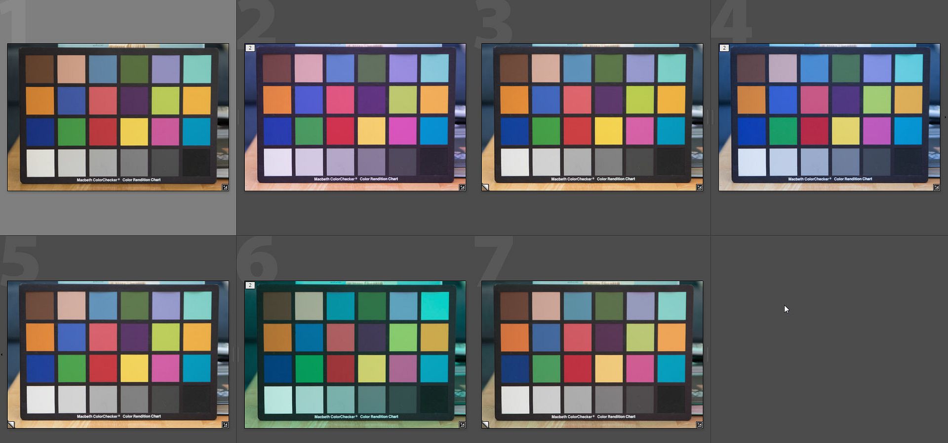

Use gels only to try to correct light sources, but not to try to counteract 'contamination' of color walls. If you have a neutral reference target, it can provide you with a good reference for fixing in post processing. I just took a series of shots, with neutral reference, with daylight and then (underexposing ambient by -2EV) with flash unit bounce off ceiling with various tinted gels over the flash head to simulate bounce against various colored wall/ceiling.
Shot 1 is with daylight, shots 2,4,and 6 taken with various gels bounced off ceiling, then shots 3,5,and 7 are neutralized versions of 2, 4, 6 and 6 during post processing

Yet look at the results I have in shots 3, 5, and 7 in Post 12!
