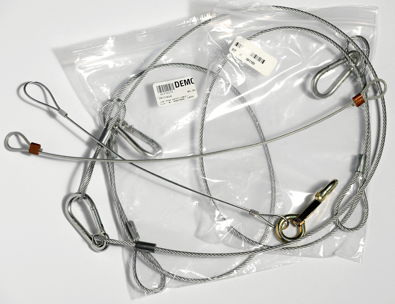

Safety first when using a boom.
To start, know your support goal. For me, the goal is placing a 20-lb load anywhere in space up to 9' of elevation with an offset of at least 4'. This is pretty ambitious as the total weight rises quickly, so I use a Junior rig with wheels. Additional gear includes the counterweight of 30 lbs and an assortment of steel safety cables.
IMAGE: http://makino.fi/rico/fm/safetycable.jpg
IMAGE: http://makino.fi/rico/fm/breguet2b.jpg
Image above shows the difference between a mere grip arm that doesn't need counterweighting, or even foot considerations with the stands I use. The Junior boom, meanwhile, is fully balanced and the total load on the stand is 65 lbs. Do I need to mention that C-stands are not to be used? :)
Due to this payload and the fact that I only have two hands, my procedure for set up begins by mounting the empty boom/counterweight assembly (45 lbs) onto the stand. The stand is preset to the operating height. The boom gets an initial balancing at this point with a strong backward torque. Then I attach the light, standing on a ladder if necessary. The boom gets a second balancing at this point. If the light is flying overhead, I connect the safety cable and cinch the power cords. After a third balancing, I can lever the rig on its fulcrum with one finger. I can also move the loaded stand with a finger.
The remaining scary factor is tightness of the riser locks. Even without inquisitive studio guests touching stuff, I decided the risk of knocking a handle or catching it on my clothes is too great. I now avoid risers which works because my largest stand is 5' at its lowest and my Avenger 650 easily hits the ceiling with a modest up-angle. For the same reasons, I always use iron counterweights that wrench onto the boom and cannot be dislodged by impact. Hanging a weight bag on a hook is insanity.
