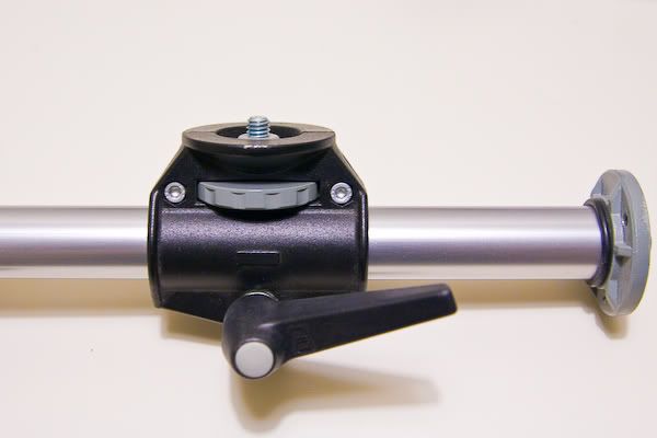

There are tripods with center columns that tilt, tripods whose legs can spread super wide to get the head very low to the ground, tripods with center columns which invert in order to get super low to the ground.
There are 'arms' like this one which mount onto the head mount of the center column to allow the head to be mounted out to one side...
IMAGE: http://i69.photobucket.com/albums/i63/wiltonw/Equipment/Bogen-1_zps8obi9egh.jpg
IMAGE: http://i69.photobucket.com/albums/i63/wiltonw/Equipment/Canon-1.jpg

Wilt wrote in post #18700477 (external link)
very interesting idea, thank you
