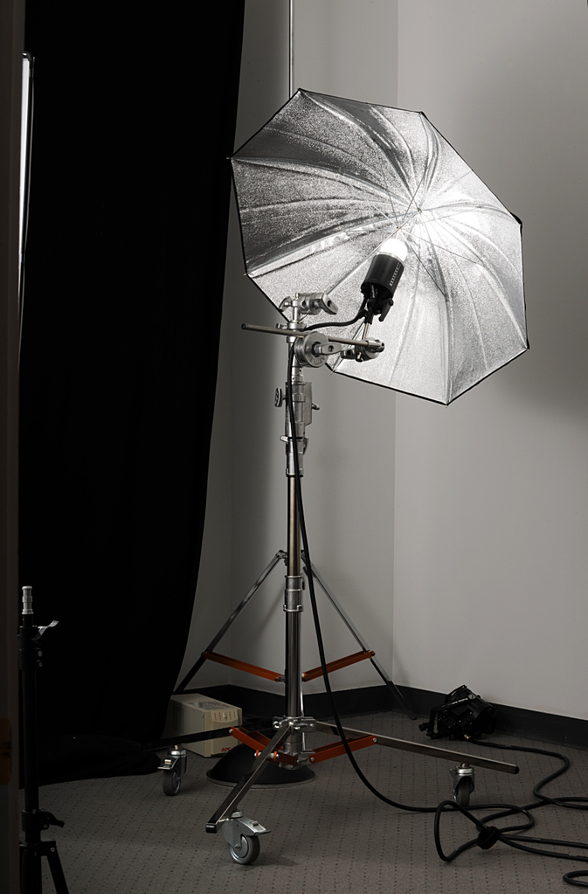

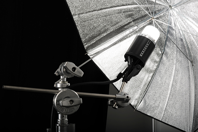

My thinking, too. Only one light stand is required if one has bog-standard grip gear lying around. The 7-8mm shaft BS is entirely avoided, and the head gains full positional freedom.

Profoto Acute heads are metal-bodied and have an integral umbrella holder that goes through the length of the interior. I nonetheless prefer external support for any modifier beyond a 33" umbrella. It's not fair to expect the light mount to compete with a cast-aluminum knuckle. :)
