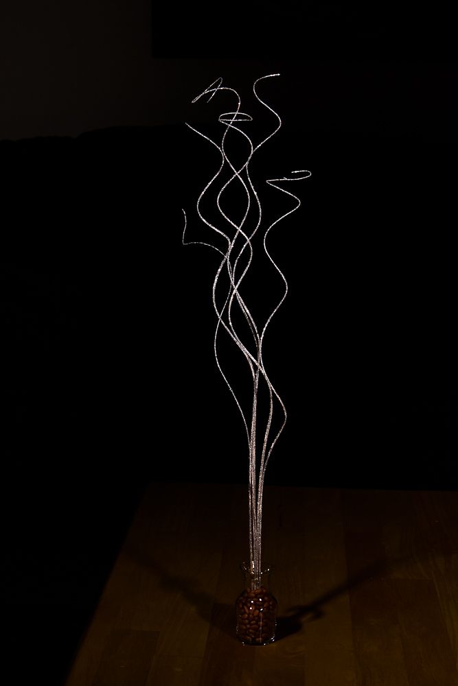

As counterpoint to the above statement -- which, BTW, I feel is a valid opinion to have for what I would call the majority of needs -- I provide the following photo, which I posted on POTN some time ago to illustrate the value of having modelling lamp in a studio strobe.
IMAGE: http://i69.photobucket.com/albums/i63/wiltonw/POTN%202013%20Post%20Mar1/IMG_8026_zps8afa7972.jpg
The presence of the modelling lamp allowed me to finely adjust the position of a small source (no modifier in use) so that the reflection of that source would appear at the tip of one of the metallic foil strands. The trial and error shoot and chimp method with a speedlight likely would have me still trying to accomplish that placement even now! :lol:
Since I could see whether or not I had the glint as I adjusted the light position, placement was much more rapid, and less frustrating to set up!
In portraiture (rather than the somewhat 'extreme' example above), the strategic placement of a shadow might allow one to hide a somewhat distracting blemish on the face of the portrait sitter. Seeing the blemish immediately fall into the shadow as you move the source around, rather than guessing and shooting and chimping, greatly eases what can be a patience-testing situation for a paying client.

I use the modeling lamp as needed but use its flash for taking. Only once have I used a modeling lamp for taking the pic.
