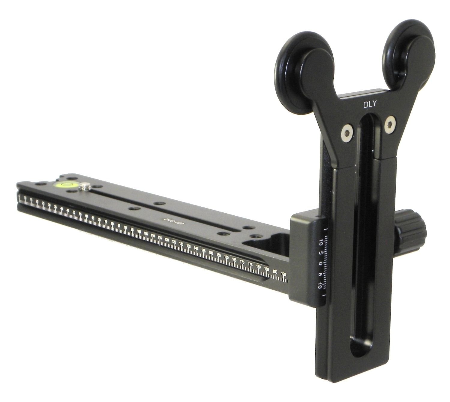

If you are really worried about supporting a larger lens, but still don't want to go with a lens collar there are these available;
https://smile.amazon.c​om …ywords=dual+dov​etail+rail (external link)
IMAGE: https://images-na.ssl-images-amazon.com/images/I/61voz7HQL2L._SL1500_.jpg
But agiabn, for a 100mm macro, I would consider this overkill.
