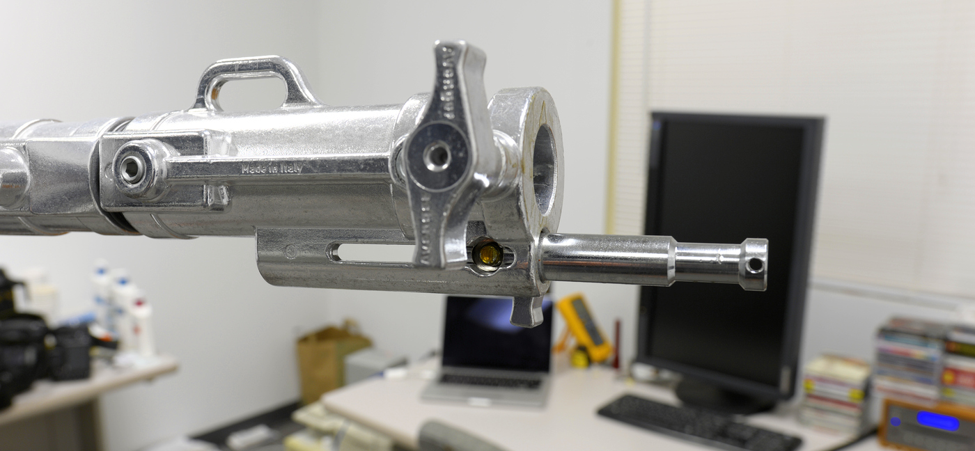

I got a bigger soft box and it does not tilt down far enough before hitting the light stand. I know I could use an off set arm, the 40' grip arm, or a boom, but I need it as compact as possible for my test bench.
Anyway, I have this 6" baby pin that I could use with a grip head for the off set. When setting up the grip head the normal way, I don't like the grip handle at the right side and I have to use my left hand to grab the light, also the pin would slide down once the handle is loosen. So why not try the head upside down? I have more control with my right hand on the light when adjust tilting.
Well that's what I thought, any potential hazard using the grip head this way?

That's fine. I use all kinds of configurations including having taken the "permanent" grip off the arm when necessary.
Edit to mention: baby pins also come with one end that is larger than the rest. It's a nice safety feature to keep it from sliding out of the grip/knuckle and your gear ending up on the floor.

Yes, it should always go in that direction. The weight needs to fall so it tightens or it will simply fall from the weight of the load.

No issues. Always keep a leg under the strobe regardless.

Thanks guys. I checked up on the Avenger pin that LHB mentioned and ordered one. I do feel safer with that pin when I hang the light like with the drop down pin :)

Which way the leg is pointed has nothing to do with the grip head ability to either tighten or loosen.
Unless you like having things unsecured and doing things wrong you always have the knuckle on the right to make it tighten by the load.

Thanks all for the safety cable suggestion. I don't hang the light dropping down often, but I do use the Kupo arm to mount the light at the tail end. Now another safety question: how to secure the safety cable to the smooth extension arm? What are your methods?
I rig up one with bank line for demo purpose, need to prevent the cable sliding out when extension arm is tilted downward.

Answer: you don't. The function of a grip arm is to hold a modifier, not a light. If you cheat in this regard then be aware of your transgression, and never endanger other people. Support components that are designed for a drop-down pin are provisioned for safety cables:
IMAGE: http://makino.fi/rico/fm/boom103.jpg
This junior boom will kill you if you turn the wrong handle but at least the safety cable is quite secure. :)
