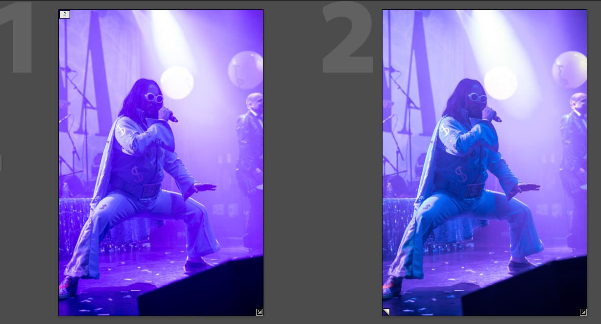

If the actual lighting was heavily colored by the use of gels, why the need to render a 'neutral' rendition of the scene?...it is not a portrayal of the reality of the scene as shot!
It is one thing to render 'neutral' a light which appears to the eye as 'white' although its WB value is significantly deviated from Daylight. But it is something completely different, in my mind, when the lighting is deliberately colored some hue other than perceived 'white'.
BTW, the bassist's white collar (assuming it is a white shirt) does balance to white when the WB value is 50000K, but the lead singer's skin still is heavily colored even at that setting.
At left is the photo As Shot with WB 5200K (dayllight), at right is the shot with WB set to 50000K and -150 in the Green-Magenta axis. Not much difference...an indicator it is not simply a WB color temperature issue!

Wilt wrote in post #18947634 (external link)
BTW, the bassist's white collar (assuming it is a white shirt) does balance to white when the WB value is 50000K, but the lead singer still is heavily colored even at that setting.
At left is the photo As Shot with WB 5200K (dayllight), at right is the shot with WB set to 50000K and -150 in the Green-Magenta axis. Not much difference!
There is no need, maybe I want to. I was purely pointing out that LR can't do that and yet a phone app (and RPP) can.
