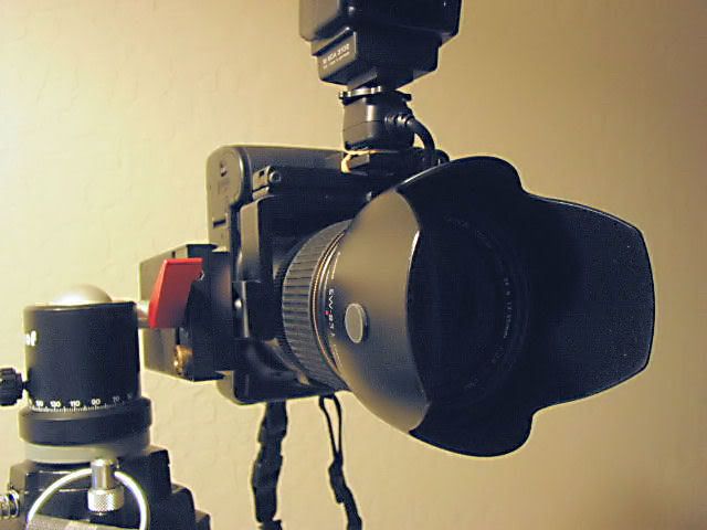

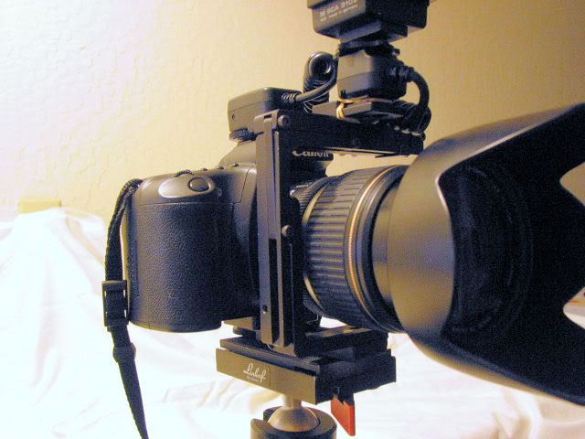

Here is a shot of an older Canon dSLR (shot many years ago) with a Newton Camera Bracket, which puts the flash directly above the lens axis to avoid side shadow. Two photos showing that this relationship to lens axis is maintained regardless of camera being used in Portrait vs. Landscape format.
IMAGE: https://i69.photobucket.com/albums/i63/wiltonw/Equipment/bracket_land.jpg
IMAGE: https://i69.photobucket.com/albums/i63/wiltonw/Equipment/bracketport_01.jpg
Note the use of the Canon flash extension cord to retain flash hotfoot functionality. The photo does not show the use of the optional Newton vertical extension to raise the flash even higher, as previously pros shot with 'potatomasher' flash units like the Metz 45, which put the light source much higher than today's hotshoe flash units, so that softboxes could be used without blocking the view of the lens.
A flash on bracket firing into a small 11x16" softbox does give a softer source than any ringflash, which are only typically small in diameter (only large enough to fit the lens in the center)
While the Newton is one of the very lightest (but sturdy!) flash brackets on the market, I would not relish the idea of slinging a camera+lens+bracket+le​ns on a hip holster due to both total weight and bulk!
I have used this very bracket to shoot with medium format film camera (Bronica ETRSi) for wedding coverage many years ago, but have not shot any weddings professionally with digital...leave that rat race for the young guys!
