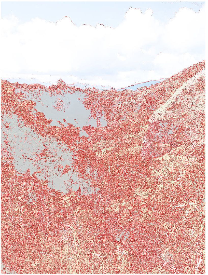

Curious, I just opened an image using Paint Shop Pro 2020, saved it as Gen1 with highest JPG quality, closed it, re-opened Gen 1 and saved it as Gen 2 with highest JPG quality, and did that thru Gen10. Then, using a web image comparison tool, I compared Gen1 vs. Gen10 and viewed the Difference display...absolutely blank (no differences found at all). Better than a subjective eyeballing to detect differences between two images, this program did a digital comparison bit by bit for any differences at all.
I figured it was the true obsessive-compulsive photographer who would re-open and re-save a file more than 10 times, so based upon my own testing I am satisfied enought that 'highest quality' (at least while using Paint Shop Pro 2020) means 'no deterioration' even after 10 generations of 'virtually same' quality.
[edit: I just did this comparison as a control test...saved Gen11 as a highest compression JPG, compared Gen11 vs Gen1 differences in red:]
IMAGE: https://i69.photobucket.com/albums/i63/wiltonw/diff_zpsvymvlc19.jpg
Keep in mind, the first test involved TEN generations of Open/Save, but the second test only involved ONE generation but lots of compression.
