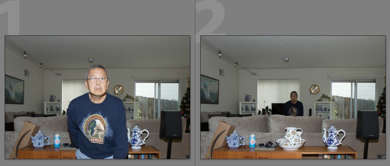

I almost never have shot with camera's flash menu set to Evaluative, so I have little experience in that mode. As a result, I just conducted an experiment, both to educate myself about flash exposure behavior, and to illustrate (or not) what digital paradise just mentioned about closest object vs. (what I had apparently wrongly :oops: claimed earlier about 'all flash zones at the same distance as the subject' being considered in flash output). Here is the test:
Camera at ISO 400, set to M with 1/30 f/5.6 selected (causing underexposure by about -3EV); flash menu set to Evaluative
On the left shot (#1) I am standing about 5' from the camera, with focus zone on me; on the right shot (#2) I am standing about 12' from the camera, with the lens focused on me for each shot.
IMAGE: https://i69.photobucket.com/albums/i63/wiltonw/POTN%202013%20Post%20Mar1/ETTL%20eval%20M%20ambient_zpso237rgrw.jpg
Notice that the amount of light lighting the room about 10-12' back from the camera has a very SIMILAR amount of light (a very small difference).
Analysis of the two shots
  1. I am correctly exposed in shot 1, yet significantly underexposed in shot 2.
  2. It is obvious that the focus distance has nothing to do with nothing, not even for the purpose of comparing zones 'at the same distance as the subject' except perhaps for highly reflective (metal, mirror) zones.
  3. And the ceramic tea pot (to subject left in both shots) is very similarly exposed in both shots...reflecting digital paradise statement about exposure for 'what is closest to the camera'
Analysis of results seen:
  1. If anything, this reflects the wisdom that flash Evaluative is best when using 'flash as fill', while flash Average is better when using flash as Main source, as it is for both test shots.
  2. Both points 1 and 3 seem to negate claims that Evaluative exposes for the closest object....as I was 2-3' closer than the ceramic teapot in shot1, the flash should have seen me in higher intensity light (by about +1EV brighter so it should have output -1EV less light, considering the Inverse Square falloff of light!) so the ceramic teapot should have been a bit darker in shot 1.
  3. Whan flash is Evaluative and the Main source of light, it does not seem to behave that much differently that I would have suspected Average to meter...the overall walls are about the same tone in both shots?! More testing is in order!
