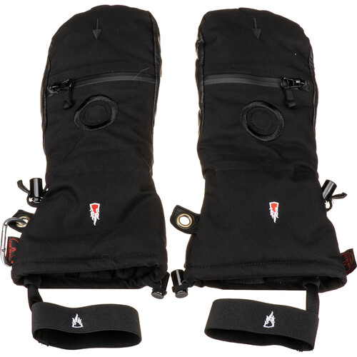

FORUMS General Gear Talk Camera Bags, Backpacks & Cases
Thread started 04 Dec 2019 (Wednesday) 11:52
Winter Photography gloves
CDN_Merlin
223 posts
Likes: 32
Location: Ottawa, Ontario Canada
Dec 04, 2019 11:52 |  #1
Hi,
Posting here as there isn't a sub-forum for it.
What gloves do you use for winter when it comes to -20-40c weather that doesn't cost a small fortune?
Canon 7D MK II, Canon 16-35mm F4L, Sigma 150-600mm Sports, Battery Grip, Jobu Design tripod
JackCharlton
305 posts
Likes: 902
Joined Aug 2013
Location: Calgary, Alberta, Canada
Dec 04, 2019 19:23 |  #2
Hey CDN_Merlin. I have a pair of woollen mitts that the fingers and thumb fold back and are held by a small piece of velcro. Under them I wear a pair of white gloves. Not sure what the gloves are made from (some kind of man made soft material that you can use on a touch screen. Got both mitts and gloves as a gift but I know my wife bought them at Marks. If its really nippy I slip a hand warmer into palm of the mitt. Works here in Alberta.
sawsedge
853 posts
Likes: 108
Joined Dec 2011
Location: United States
Dec 10, 2019 22:53 |  #3
I haven't been out photographing in weather quite that cold yet, but I have had good luck with my Hand Out Gloves for warmth in well-below freezing temps. If I stand around waiting for the right moment, I stay quite warm with them on. You can pair with with a good wool or silk liner, something thin that gives you good dexterity.
They zip across the knuckle, letting you free all 5 fingers on demand, change a control on the camera, then zip back up. Where I find them awkward is they fold down over your palm and I tend to hit things with them.
- John
Tom ­ Reichner
"That's what I do."
17,636 posts
Gallery: 213 photos
Likes: 8386
Location: from Pennsylvania, USA, now in Washington state, USA, road trip back and forth a lot
Dec 10, 2019 23:57 |  #4
I'm not sure what the celsius conversion would be, but I am regularly out shooting in temps between 0 and 10 degrees Fahrenheit. . I spend as little as possible on gloves, as they get dropped and lost so frequently. . But I do need gloves that insulate very well, despite low cost.
What I've found to be best on a performance for the dollar basis are heavyweight polyester fleece gloves. . Just simple ones that are only fleece throughout. . Any kind of lining or palm treatments tend to drive the price up. . When I find this type of simple fleece gloves for 7 or 8 dollars a pair, I will buy a couple pairs.
I keep a clothing accessory bag in my car at all times that is full of gloves, socks, hats, balaclavas, scarfs, etc. . There are always a few pairs of these very heavy fleece gloves floating around in that bag somewhere. . When I head out into the cold to shoot, I put one heavy pair on and put another heavy pair in my pocket, so that if I lose a glove or get one soaked I have immediate access to a spare.
My hands always stay warm enough when wearing this type of glove, down to around zero Fahrenheit.
Sometimes I need better finger control than these heavy fleece gloves will permit. . So what I do is to also have a pair of lightweight cotton jersey gloves in my coat pocket, in addition to the spare heavyweight gloves. . I get those at the dollar store for a buck a pair. . During the minute or three that I am actually shooting or working the controls on my camera, I will switch the heavy glove on my right hand out for one of the light cotton gloves. . As soon as the camera work is done and I am back to hiking or searching or waiting for another shooting opportunity, the heavy fleece glove goes back on.
"Your" and "you're" are different words with completely different meanings - please use the correct one.
"They're", "their", and "there" are different words with completely different meanings - please use the correct one.
"Fare" and "fair" are different words with completely different meanings - please use the correct one. The proper expression is "moot point", NOT "mute point".
gewb
1,009 posts
Gallery: 326 photos
Likes: 2229
Location: Denver, Colorado USA
Post edited over 3 years ago by gewb.
Dec 11, 2019 07:34 |  #5
I use a layered approach. First a thin glove liner, also refered to as runners gloves, base camp wear, etc. then over those I use larger fingerless mittens that flip over the fingers. You can poke out just your shutter finger with ease. If your camera has a touch screen, get the liner gloves made for screens.
This combo is ok at -20C but that is about the limit. Anything that goes down to -40C will be expensive and bulky. (-20C = -4F, -40C = -40F)
IMAGE: https://photography-on-the.net/forum/images/hostedphotos_lq/2019/12/2/LQ_1014912.jpg
Image hosted by forum (1014912) © gewb [SHARE LINK]
IMAGE: https://photography-on-the.net/forum/images/hostedphotos_lq/2019/12/2/LQ_1014913.jpg
Image hosted by forum (1014913) © gewb [SHARE LINK]
90D / 60D / Pro1 / A85
Bcaps
I was a little buzzed when I took this
1,019 posts
Gallery: 90 photos
Best ofs: 16
Likes: 2605
Joined Jun 2003
Location: Bay Area, CA
Post edited over 3 years ago by Bcaps.
Dec 11, 2019 10:15 |  #6
I have a pair of these and they work great.
IMAGE: https://static.bhphoto.com/images/images500x500/1548339683_1450252.jpg
The top of the mitten unzips and flips back and snaps in place exposing the integrated liner. You can do the same with the thumb. There is also a pocket where you can put hand warmers to keep things really toasty. There are a number of reviews on youtube.
https://www.bhphotovid​eo.com …1PQxzKKMzDjxoCc​vIQAvD_BwE (external link)
- Dave | flickr (external link)
Nikon D810
14-24mm f/2.8 | 16-35mm F/4 | 24-70mm f/2.8 | 70-200mm f/4 | Sigma 150-600mm
1,816 views & 4 likes for this thread, 6 members have posted to it and it is followed by 3 members.
Winter Photography gloves
FORUMS General Gear Talk Camera Bags, Backpacks & Cases
1064 guests, 100 members online
