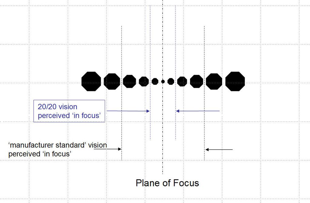

vanillaslice wrote in post #18974751 (external link)
How is focusing stopped down less precise? I don't understand that concept.
Isn't focusing with the aperture wide open, when really it's going to be a much wider DOF less precise? (As long your aperture isn't set to the lowest possible)
Think of focus as 'attaining a certain amount of acceptable fuzziness'...when DOF is 1' deep you can be perhaps 4-5" in error and the camera still thinks 'acceptable enough amount of fuzziness'. (speaking purely for conceptual illustration only, not based upon the actual amount of 'acceptable fuzziness' programmed into a camera!) If the DOF is 100' deep (when focusing stopped down), you might be in error by 30' yet the camera still thinks 'acceptable enough amount of fuzziness', but you are truly 30' in error away from 'optimum' focus point.
I made this illustration a long time ago, but it helps to illustrate DOF
IMAGE: https://i69.photobucket.com/albums/i63/wiltonw/Principles/DOF%20zone_zpslnv5b7m4.jpg
With a subject distance like 20' the range of distances between the 'perceived in focus' line is pretty narrow at wide open (focus) aperture, but if the range of distances between the 'perceived in focus' line pair is pretty wide because of small aperture during DOF Preview, you can be a lot more 'in error' away from the Plane of Focus.
