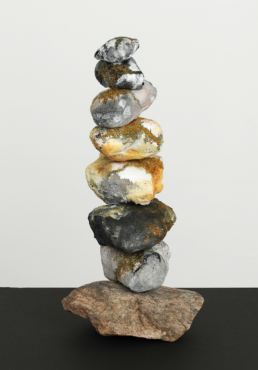

Sep 01, 2020 21:16 |  #19
Pete E wrote in post #19118478 (external link)
I am basically trying to produce flat evenly lit almost shadowless pictures of an object, with no artistic licence allowed...if I can get to grips with this, I may venture into using flash for my own pictures of these items, but that will be a bit further down the road.
As mentioned by windpig, you don't need modelling lights or continuous ring lights if the lighting is to be flat and shadowless. Shadowless is synonymous with directionless, and for that you want to use a room-sized bounce from a flash or strobe. The room should be all-around white or off-white, while the lighting instrument can be a single $20 manual flash off eBay. No further lights or modifiers are needed.
IMAGE: http://makino.fi/rico/nikon/misc/art100.jpg
I shot a heap of such objects for an art catalog in assembly-line fashion with no exposure adjustments at all.
