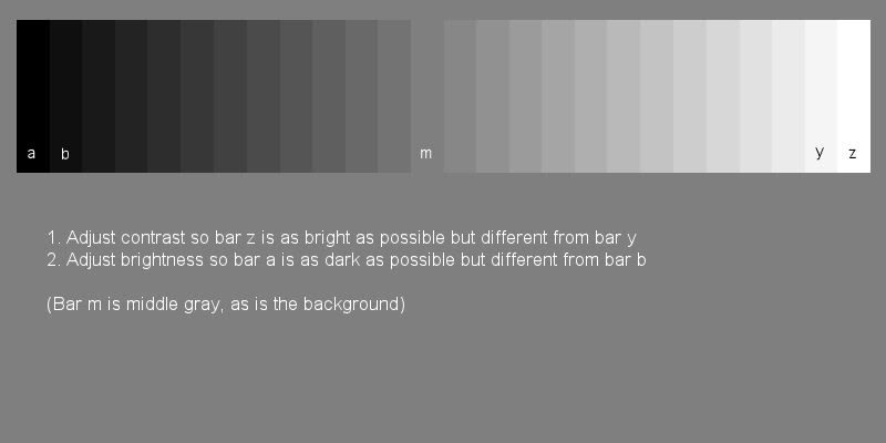

If your prints are 'too dark', I presume that you failed to start with fundamental monitor Brightness and Contrast adjustments BEFORE doing monitor calibration (which affects HUES) How does this image look on your monitor?
IMAGE: https://hosting.photobucket.com/albums/i63/wiltonw/grayscale_adjust.jpg
IMAGE LINK: https://app.photobucke​t.com …9f-4701-887e-c17b85c6d11b  (external link)
Adjust Brightness and Contrast to be able to discern all 26 steps, then redo your monitor calibration for Hue.

Making progress. I did check brightness and contrast based on the included graphic. I have had a copy of that for quite awhile but keep forgetting about it. Both contrast and brightness were off. Contrast by about 10; went from 80 to 91. Brightness was off by a bunch; went all the way down to zero.
With the most recent adjustments and re-calibration after adjust contrast and brightness, I am seeing much closer results between monitor and prints. When I re-calibrated, the calibration wanted me to raise the brightness which seemed odd. I did but I have since dropped it back to zero which seems to be much more in line with what I see when I print.

If your doing the calibration properly, it will set the contrast and brightness for you.
But it is very dependent on the luminance target you set, which is how bright you want the monitor based on the light levels in the room.
